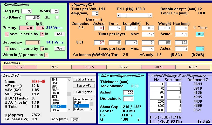

OPT_da doesn't work for me (Win10 64 bit).
I'm getting an error in the "windings" window and no results at all in the "copper" window.
Thanks.Try my version (extended cores and wires).
comdlg32.oxc acts up. My french is non existent, but the dialog box says missing or corrupt ocx file.
I've tried both the 32bit and 64 bit versions placed in the OPT_ad folder but no luck so far.
On the download site for the comdlg32.ocx it says to place the ocx file in the same folder as the rest of the program, or;-place the 64 bit version in the system32 folder or the 32 bit version in the sysWOW64 folder, which sounds downright wrong.
