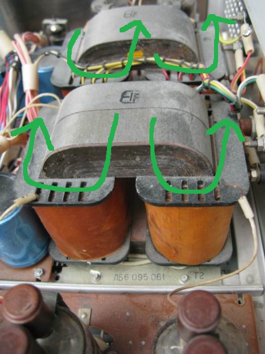

Hi , So i recently finally repaired the output transformer of my Priboi , one of two was broken had one of it's two bobbins shorted between primary and secondary ,
so each of the two output transformers (one for each channel) has two bobbins on a common C shaped core , each bobbin has 3 layers of primary winding and two layers of secondary which are sandwitched between the 3 primary ones.
the fact that made me wonder is why one channel has the output transformer both coils wound the same direction while the other channel has both coils going the opposite direction to each other , like almoust the flux should cancel but it doesn't it works instead that way because when I first my accident wound it the same direction as the other channel and also the one which my logic told me it didn't work.

It doesn't make any difference. The difference is the phasing in the wiring, not the build. For instance if one winding is clockwise and the other anti clockwise, finish to start for the centre tap looks neat but can be outer to outer or inner to inner.

Your c-core transformer "right" coil's magnetic field has "north" orientation (take right hand rule). If your hand wandering over the /double/ c-core, the "left" coil's magnetic field will be "south" orientation and current direction will be opposite as in "right" coil.
