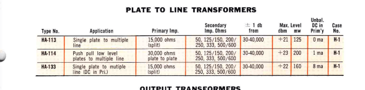

This transformer is a UTC HA-114, I have attached an image of the datasheet.

When I look at modern transformer datasheet made by Sowter for example, they specify the maximum primary DC current in each winding. This makes it a lot clearer what output stage they can be used for.
From my understanding "max unbalanced dc in primary" only tells how much the output tubes can be mismatched without compromising low frequency.
It doesn't actually tell how much current can flow in the primary wire before meltdown.
Unbalanced DC in primary: 1mA
This means that the tube used must be well selected for pp

A 10% imbalance is usually acceptable in good PP OPT's. So for 1mA you get 10mA as a typical idle current. I think you have a OPT usable for high Z headphones. 600R headphones and the driver tubes would be line stage types that run 10mA class A maybe balanced circuit ... just a guess. But you are starting with some good info on that tranny. Good luck finding an equation to assess an totally unknown tranny. It's a perennial question.

Yes, 10/10. So you could have 9/10 or 10/11 for a 10% imbalance. My solution to unknown trannies is to avoid acquiring them or dump them. I don't like having underutilized or components with questionable reliability in my creations. Scrap value is nil. A 10K/8R 10W tranny is not the same as a 5K/4R 10W tranny or they would be labeled as such.
