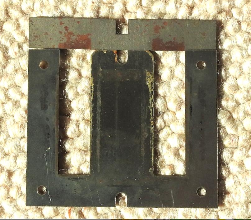

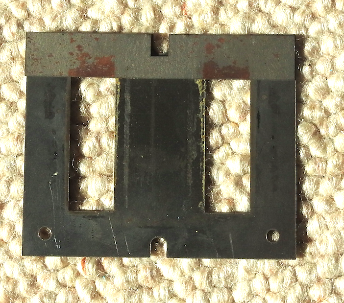

A quick question for anyone who knows about these things- I have an old PT that I was thinking as using for a first "learning" attempt at winding , for a 6l6 SE amp. Unfortunately the lams are drilled in the middle as well as the corners and the tongue trimmed on its corners , am I right in thinking that this will be useless when butted?

There should only be *two* of those funny looking E lams from the 2nd pic. Those are supposed to go on the outside. The inner ones are straight. Half of the time, I end up sacrificing one of those outer lams just to get the disassembly process started. It gets mangled.

I hope it's not a one -off , as I said it's a learning experience and I'm OK with learning from my mistakes. Thanks to wg_ski , I checked and it's just the end lams that are cut on the corners. I'll press ahead with it , it' a guitar amp and I'm just following my interests- I've already wound pickups for my guitars so I'm not coming into it cold , and at least trafo wire is THICK and doesn't snap on a whim like pickup wire!

The rounded center leg ones are mostly cosmetic, real ones (99% of them) are flat tops.
