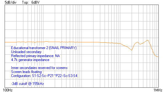

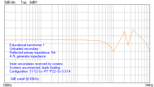

This is excellent data that I would love to be able to do myself.I attached some images from my measurements:
I am not however 100% clear on your test setup.
Honestly I believe your test setup deserves it own thread and I think members like myself would benefit from the learning.
Measuring transformers and coming up with good data is a poorly understood area for many including myself.
If you can find the time it would be great to see a thread on the measurement methods you used here.

If you do not know how to calculate P/S capacitance, check Patrick Turner's papers, he explains it quite simply. I'll try to do so as well.

I've experimented some years ago. In some cases it might bring a little benefit, but the most detrimental factor remains the series connection of secondaries.
This doesn't mean of course, that one cannot get good performance with series secondary connections, but has to respect some rules. For example, this is not a problem with balanced push-pull transformers wound on two coils, where the P/S capacitances between both layers are equal. This brings no crosstalk between the primary layers, on the terms that the secondary ground point is also a mid one, not on one end. PP transformers, if correctly built, are easier in terms of parasitics.
To get good insight on advanced transformer design, one needs to elaborate each specific scenario with its unique interleaving schematic and application carefully. Rules on different transformers are not universal, different toolbox techniques apply for SE, PP OPTs, step-up, step down, unity interstage transformers, etc. OPTs for example are more forgiving towards capacitance distribution mistakes, whereas with interstage transformers, it is easy to screw up.

Bonus. Here are practical measurements of interleaving schematic 1 vs schematic 2.
