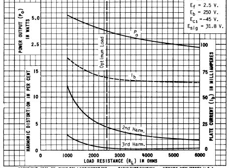

The 2A3 sheet says no such thing. OK, maybe the trace rises a hair above 3.5k, though this may also be a crooked T-square or just measurement slop.
*IF* the 3rd rise at high Z, it is usually because the tests were run at HIGH signal level. 2A3 was run at -45V bias, 31.8V swing. Which is 44.52v swing, and probably near significant grid current. The 6L6 data is 14V bias and 10V signal, "slammed".
If you had an actual 3rd THD spec to meet, you would *turn down* from this extreme (power output boast) conditions and 3rd would fall right off.
I can't imagine needing 15W-19W tubes to drive headphones. Is your house cold? However running a 5 Watt amplifier at 0.05 Watts should put your THD way-way down.
If you are concerned with numeric THD, you need NFB, which is simple to implement.

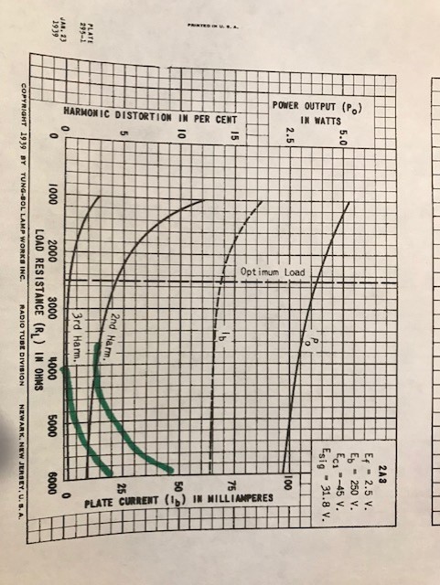

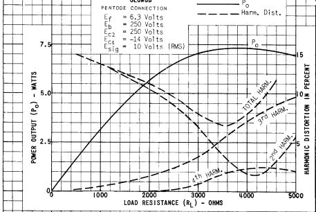

Here are curves typical of those which stimulated my question.
The first shows a typical pentode with 3rd harmonic increasing with increased load. The second shows a typical triode with 3rd harmonic decreasing with increased load.
When a pentode is triode strapped does the curve for the 3rd harmonic swing up on the left like a triode or on the right like a pentode? (these curves seem typical, and would be much the same for 6Y6, 6L6, 6V6 etc.)
You did not get the point.
When load impedance (r) increases, the swing of anode voltage increases (gm*r); so the tube starts saturating unless you increase B+ accordingly. When swing increases the saturation gets more symmetric, all distortions increase, except even order ones that decreases due to symmetric saturation. Simple math, Fourier transforms. No magic here essential to the particular tube.
Another thing to keep in mind when increasing the reflected load is you wind up decreasing your voltage gain from your winding ratio. You have to compensate the higher stepdown by driving your output stage harder, increasing distortion. I noticed this with my current breadboard. By wiring the secondaries in parallel, my reflected load was over 100k, but the distortion was higher due to the higher drive requirements. Your best bet, I believe, would be to find out the drive requirements for your headphones. From there you can find an appropriate turns ratio that would deliver sufficient power with a bit of headroom when plugged into your preferred source. There is a point of diminishing returns in my experiments. In fact, if I further reduce the stepdown ratio (and the reflected load), I very well could get the distortion lower. But at that point, I would be risking damage to my cans from the increased deliverable power.

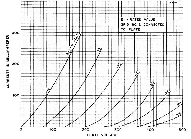

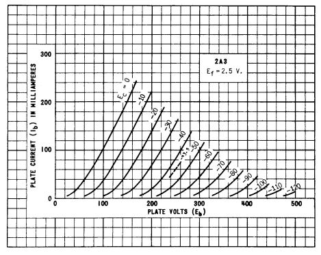

This is fun!
As a newcomer to valves I have asked many questions on this forum, some less clever than others, but I have rarely provided answers.
I had questioned the relationship between load and distortion for a triode-strapped pentode. The typical data sheets show graphs of this relationship for trodes and pentodes, but not for strapped pentodes. The triode curves show distortion increasing at low loads but never at high loads, but the pentode curves show increasing distortion at both low and high loads.
The answer is distortion for a strapped pentode increases at both high and low loads. The three attachments show two plate characteristic curves (first for a real triode and then a triode-strapped pentode) and then an abstract sketch of the resulting relationship between distortion and load.
Note that in the horizontal axis the load lines for the real triode are evenly spaced, and therefore rotating the load line horizontal (higher load) will not increase distortion. However for the triode-strapped pentode the load lines are compressed on the right, so as the load line is flattened distortion will increase again, somewhat like a normal pentode.
Yes the math is easy, but a graph is worth a thousand algorithms and helps me quickly visualize the general relationships.
And yes this is wasting time. But this is a road-trip where the objective is discovery. The interstate highways and drive-through windows are to be avoided. If the result is eventually a headphone amp, that is also OK.

Triode strapping a tetrode is a great way to get a linear tube with a low cost, and in some cases (like sweep tubes) there simply isn't a triode made that compares. 6P45S triode connected for instance, has a mu of about 3.3, and an rp <300R but can handle 400mA steady state current with peaks to over 1A. A 300B can't do that and costs several times more money. As far as the OP is concerned, they could probably use EF86 tubes for headphones since the power requirement is so low, but I still prefer the OTL amp I posted earlier in the thread. As far as the 6080 goes, it's not very linear, hard to drive, and is expensive to heat. It makes a good pass tube but that is what it was designed for, right?
I think I need glasses. This whole time I thought the 6as7g was linear. I put the plate curves in MS paint and drew some lines, and sure enough its not a great tube.
Well crap. It would have been a really nice tube for the op because he would have been able to do darn near every topology he has talked about.
And yes, triode strapping a tube is not a terrible practice, but for a headphone amp, I sort of feel like its pointless. I mean you can literally use a single 6c45pi in a spud style amp and it would still be more than enough.
