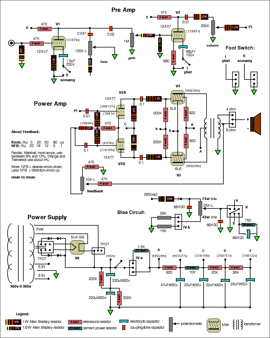

2.) The transformer is 4 and 8 ohm for a push pull setup, the power section is close to a Bassman clone. I am having trouble determining which lead is which. The resistance between the two secondaries is .7 ohms as is the resistance between the green secondary and ground. This tells me that would be the center tap and such would be the 8 ohm lead. The resistance between the yellow and ground is .9 ohms which tells me it is longer and should be the 4 ohm tap. It definitely sounds better in my 8 ohm speaker with this configuration, but with the little electric shock mentioned above I'm really not sure. Or sure that it's related.

That diagram is wrong. The eight ohm tap should have higher voltage than the four, thus more turns. If you've got an oscillator (doesn't have to be a great one) you can run it into the output of the tranny (with the amp turned off; the anodes aren't going to give any reading while cold. Great, tubes, aren't they?) and you can measure the voltages at the various taps. Cold to eight ohm is the highest voltage, cold to four about two thirds of that (yes, I know one over square root two, but I'm not calibrating to a tenth of a dB for broadcast authorities here.)

Chris: about the diagram, are you referring to the drawing of the OT and the way I have the 4 & 8 ohm taps drawn in? I didn't really think about correctness, only to show that it has two taps. And can one tell the impedance of the tap being used by measuring the voltage coming out if I use an 8 ohm resistor and select the four ohm tap on the switch and then the 8 ohm tap? I don't have an oscillator to use. So I am thinking that the voltage coming out will be different if I have it switched in 4 ohm mode with a 4 ohm resistor, than in 8 ohm mode with an 8 ohm resistor.
