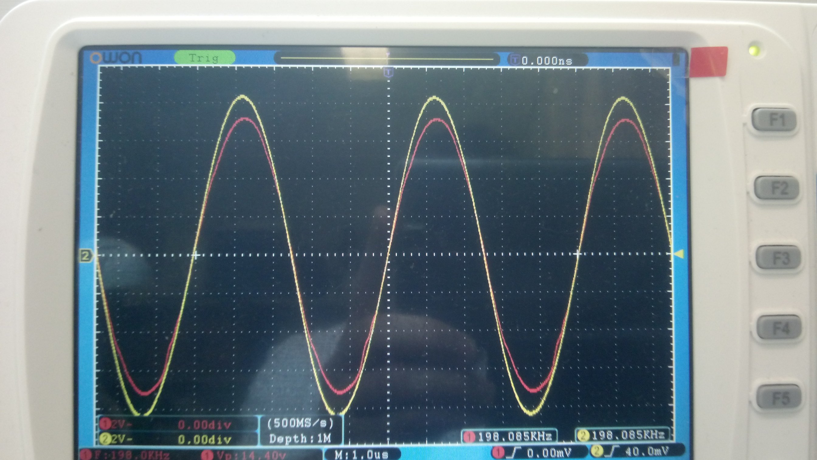

Rails are 10.5V to 13V each. Trying to push 8V peak into 1R load at 200KHz, fixed frequency. There is no gain, as you can see on the schematic. It is just a current buffer stage.
The circuit has been built and works fine until the point where we (a) lower the load close to 1R AND (b) approach the rails too much (a little over 8V peak).

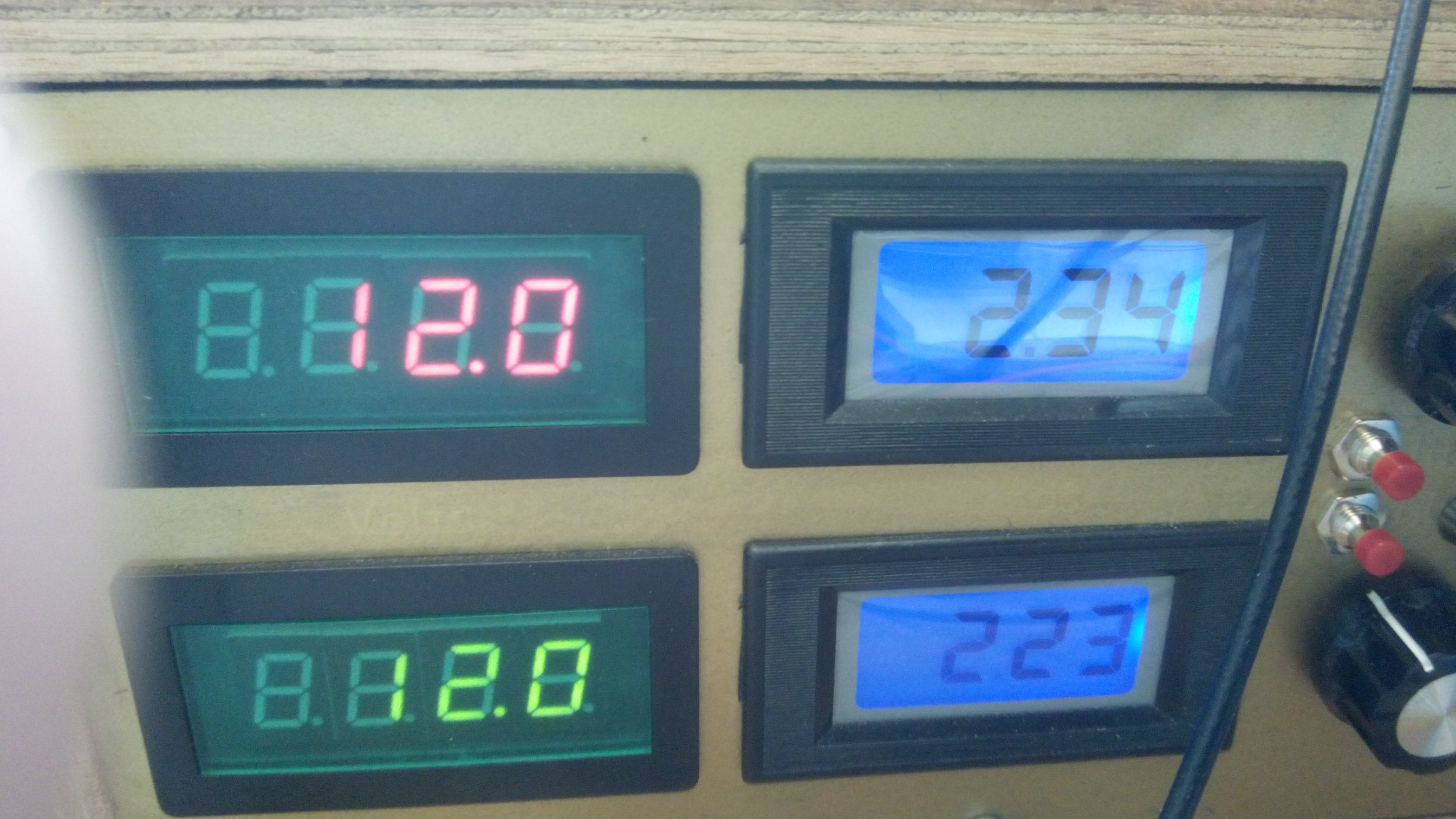

For example the built device works fine with +/-12V voltages, 8V peak into 1R load, no probs.
Now try to lower the rails to +/-11V and you get instantaneous thermal runaway. Curable with lowering the bias, which was fixed and without thermal compensation.
Also curable with increasing the rails - but it is running off a battery so we do not have many luxuries. We cannot afford to sacrifice rail voltage, we cannot afford to throw away power, and we do not have space either, so it is not easy to mount 8 output transistors and heatsink(s) into the case (but am trying).

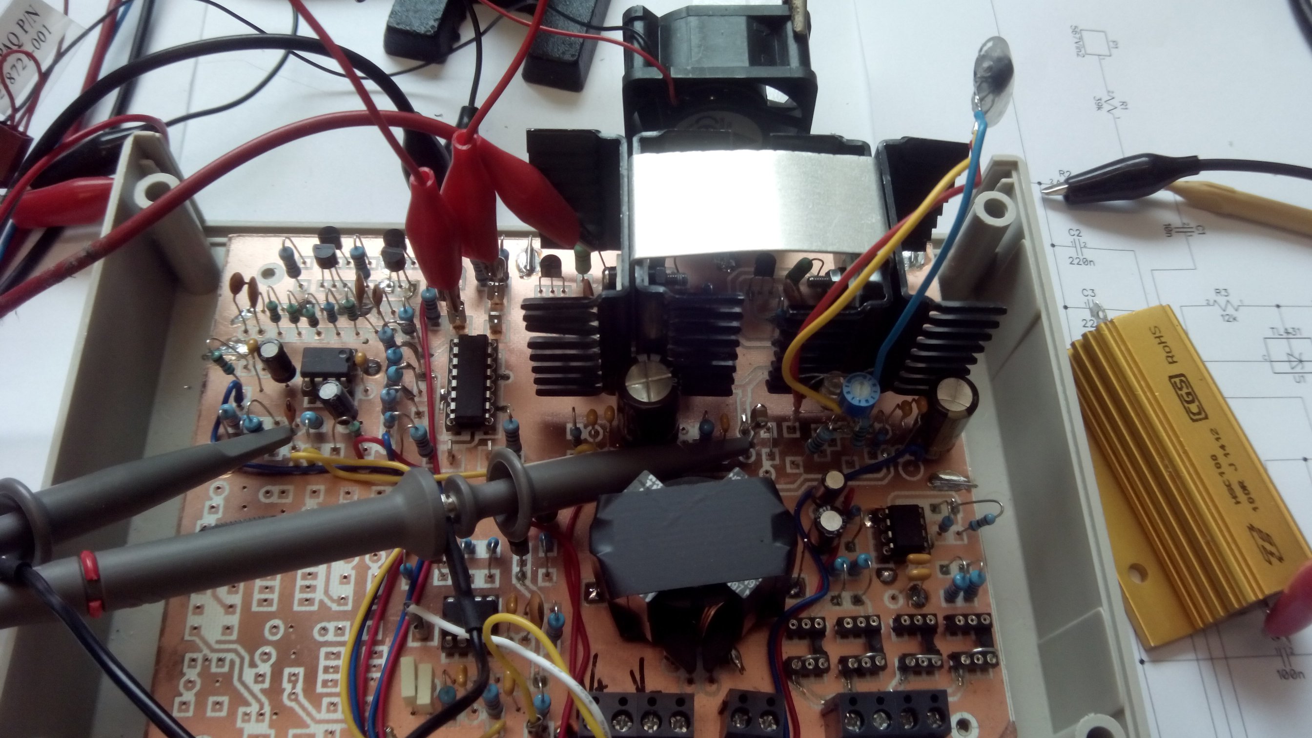

I have taken some pictures so you can see where I am now.
You can see the tightness of the case, 4 output transistors mounted back to back and the heatsinks linked together. The drivers are not mounted on anything and with or without airflow from the fan they are at a steady 25C-30C. Without fan output transistors go over 70C after a few minutes. On the scope you can see input (yellow) and output curves. With very little bias there is harmonic distortion (bottom of curve) but that cures itself on load as the bias increases due to heat. The input wave is a little over 8V peak while the rails must be at over 11.5V to handle the loads.

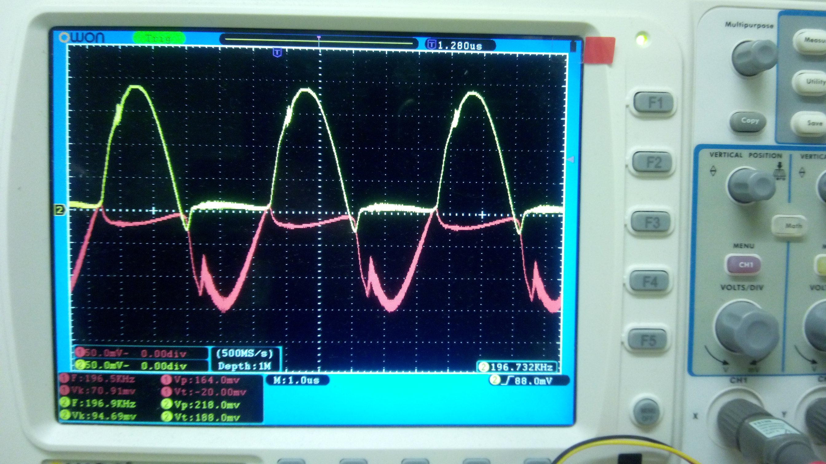

A quick update while I am debugging.
I have made a new board using 3 sets of transistors, and the problems are exactly the same as before. The Re are now 0R15 each, used to be 0R10 with two transistors.
The problem is that the circuit works ok and is thermally stable, until I increase the load beyond a certain point. At that point there is a very quick thermal runaway, lasts a few seconds before the bench PSU current limit kicks in. It is not possible to sense this thermally as the heat does not really have time enough to travel outside the transistors' cases.
Funnily enough, if I increase the rails, which ought to make things even worse, the circuit works better. This is weird.

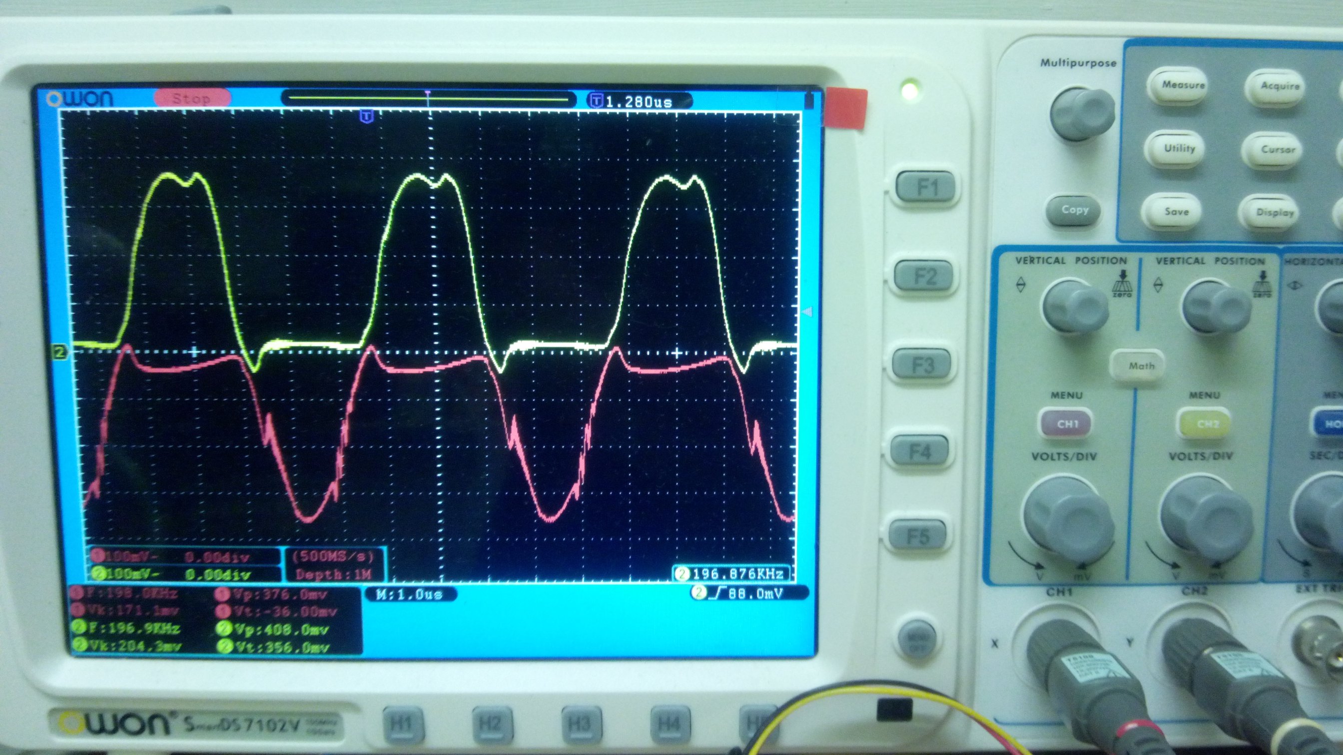

Doing some debugging now and there are two screenshots, taken at a random emitter resistor (there are 6 to choose from). On the first picture the load is around 1.8-2 Ohms and you can clearly see one transistor opening while the other one remains closed. More or less.

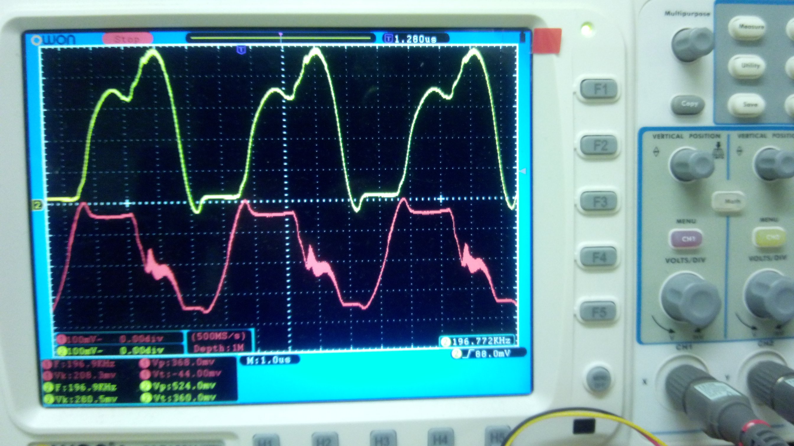

The next picture shows what happens when the load drops to 0.8Ohms or so, the transistors both stop closing as they should, they remain open for more of the cycle than they should and they both "play" into each other, thus consuming a lot of power.

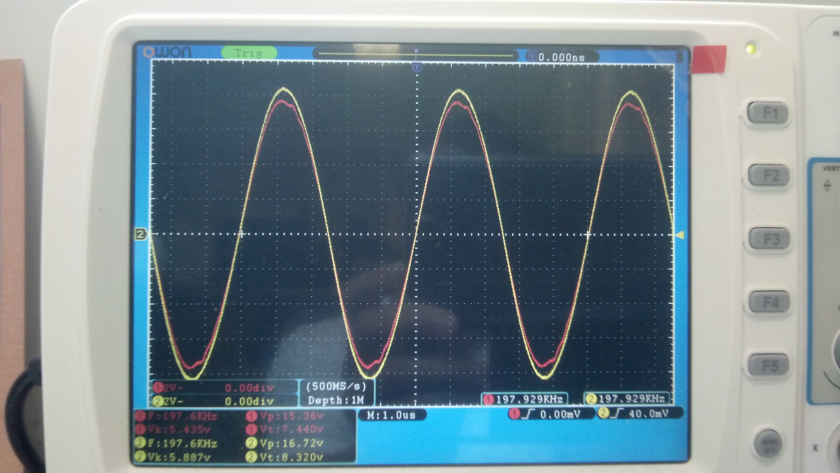

The last picture shows the exact same situation but with rails increased by 1.5V each. As if by magic, no thermal runaway.
If anyone has any new pointers please let me know. My next step will be to try bigger transistors.

You're running into cross-conduction or "shoot-through", as it's called in Class D. Try higher driver current.
So I take it you have 3 CFPs in parallel? One CFP with multiple transistors may be worth a shot.
People are not generally expecting full power output at almost 200 kHz in audio, so you may want to consult with the RF crowd as well.
OK so now I know that there is a known problem and there are multiple people in that thread that know exactly what it is even though I do not understand their suggestions and the OP was switching between real design and simulation thus confusing the issue.
I tried increasing the driver current, no change. I do not understand what you mean by "one CFP with multiple transistors" ?
I have started a new thread entitled "Cross-conduction with complimentary pairs"
