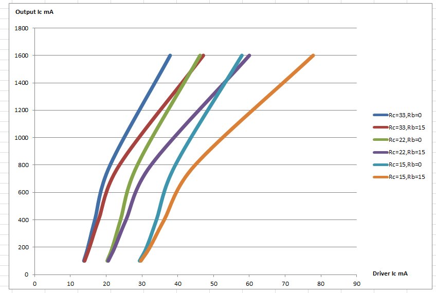

I have run some simulations to understand better the role of the base stopper.
These two graphs show the compund pair's beta vs the output current. Rc is the collector resistor (typically 100R but for HF applications as low as 5.6R) and Rb is the base stopper resistor.
As it can be seen the overall beta of the pair depends heavily upon the collector resistor, the higher the better.
The base stopper resistor lowers the compound pair's beta, as currents increase.
Because we have added the base stopper resistor we have effectively limited how fast the output transistor can close and we have introduced cross-conduction again (at HF).
We then have to lower Rc futher in order to combat cross-conduction.
But this now means that the driver transistors are doing more work, as can be seen on the second graph, which shows the current through the drivers against the current of the output devices. As the collector resistor decreases, the drivers have to work more.

Thinking in terms of beta is certainly not very helpful: that is true in general, but particularly so in tackling parasitic oscillations.I have run some simulations to understand better the role of the base stopper.
Think about the (artificial) variations of the apparent beta the resistors cause to the compound: they don't make a lot of sense.
You just have to make sure the transistors receive enough input current under worst case conditions to deliver the required worst case output current; and, of course, the resistors influence these calculations, but going further is misleading, and probably a waste of time.
Stoppers work by compensating negative impedances, and by introducing HF rolloff when combined with the inherent capacitances of semi's, not by reducing beta.
For oscillations to occur, the power gain needs to be >1, and this condition is easily met, even when the effective beta is <1.
Note that stoppers can sometimes aggravate the problem: negative impedances can present themselves under parallel or series guises: with the parallel type, adding a stopper will make thing worse.
Anyway, the main problems reside in the layout, and input or output impedances: even a CFP could be made stable without any stopper or similar band-aid, but migrating towards an EF topology would make many things easier.
