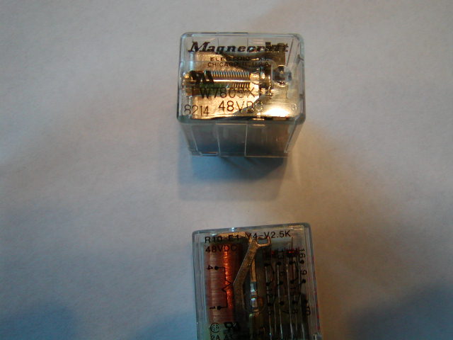

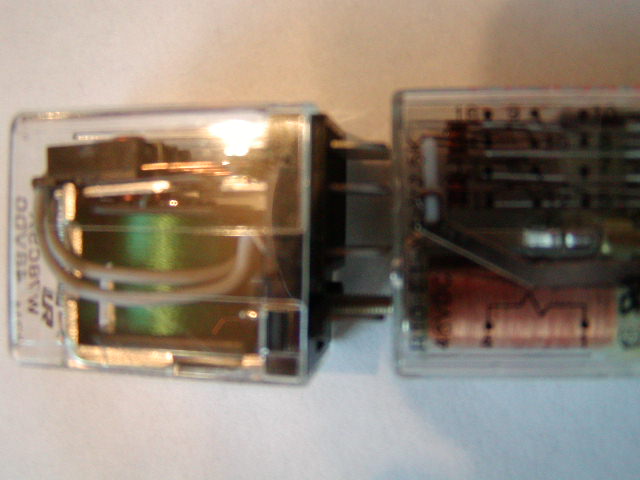

d3imlay said:Does anyone have any success stories where the output relay on a failed amplifier disconnected the speaker and prevented speaker failure? How about relays that welded.
It seems to me that the time delay for the sensing circuit to trigger plus the 10-20 millisecond delay that it takes for the relay to drop out would allow a failed amplifier to damage the woofers. Even if the voice coil doesn't burn, I'd expect the coil to jump the gap.
Very few relays have contact ratings greater than 28 VDC. Certainly the relay contacts would weld shut on most any amp good for 100 watts or more (50VDC or more rails).
Actually, there are relays rated at thousands of volts and thousands of amps.
The response time isn't usually an issue as relays are for disconnecting in the case of DC offset more than catastrophic failures
Try a fuse 🙂
Yes there are very high powered relays !we call them contactors
I have used them with great success in power amplifier spk protection and I would prefer them in every case to any solid state protection scheme
They can be designed so that all amplifier condition must be correct before connecting the load(speaker)
They can provide with suitable circuits switch on thump prevention They are used to completly isolate the spk if there is a fault I am with them every time
