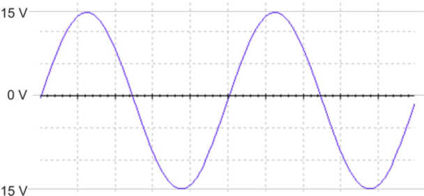

Sorry for my mistake not 50V p to p.
Max +/- 50V swing saw in oscilloscope.
That will be 100V p to p
100Vpp=50Vpk=50/(root2)Vrms or Vac = 35Vrms
Power delivered into a 4r load is
P=Vpk*Vpk/2/Load=50*50/2/4=312.5W
Maximum current when delivering this power is
Ipk=Vpk/Load=50/4=12.5Apk
That power & I peak cannot supply from my power supply.
I average saw in oscilloscope is +/- 30V
30Vpk=50/(root2)Vrms or Vac = 21.21Vrms
P=Vpk*Vpk/2/Load=30*30/2/4=112.5W
That may be possible for my power supply.
I think I must use sine wave generator for measure true power output.
Is that true ?
Can Output power vary because of frequency ?

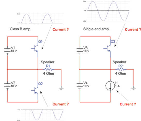

Every one said that the current was to low. To have the correct current, 3 Amp for the amp is it the same as – 1,5 amp negative side sin wave and + 1,5 amp on the positive side or …? (see picture with red questions.)
How is it with the class B amps? is it -1,5 over the PNP (– side) transistor and 1,5 over the NPN transistor (+ side), (see the picture). How is it with Single end where the whole signal is on one transistor and you have a current source? Should the current source was on the whole current 3 Amp or… (see picture.)

Adding pk (zero to peak) or pp (peak to peak) as a suffix usually clarifies and avoids ambiguity.

the ccs shown on your single ended amp carries constant current.
The load current is correctly shown as peaking at Ipk. But the arrow is pointing to the transistor, it should be pointing to the load.
The extra current, to supply the load, comes from the working output transistor.
It's current is Iq +-ILoad and can vary from zero (or almost zero as distortion increases badly as zero is approached) to two times Iq (again almost twice).
So much for all the erroneous references to constant current in a single-ended ClassA amplifier.

Hi Progg70, sorry if i sound rude, your questions are too fundamental, you really need to work out them on yourself. Without understanding how all these currents sum up, you will never be able to understand any electronics/electricity. You must learn that by understanding.
A few hints:
- Q2 is reversed, the emitter needs to show up.
- The current through a ccs is constant, that's what makes it a current source.
- Get perfectly familiar with ohms law, I = V/R, V = I*R, R = V/I
- Think of currents like flowing water. You know what current is flowing through the 4ohms. This current needs to be a sum of the currents from both transistors, but don't forget the sign ! (The direction of the current flowing)
An example for the single ended:
- outputvoltage +1v, current through 4ohm is 0.25a, current through upper transistor is 1.25a
- outputvoltage -1v, current through 4ohm is -0.25a, current through upper transistor is 0.75a

Kirchhoff's Current law:
