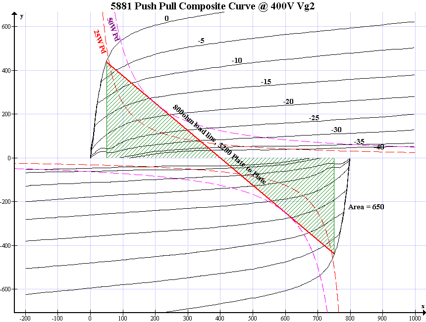

My specific question about the multiplication of the loadline impedance times the value of 4 came after reading the audio Classroom articles by Norman Crowhurst. It is the five part Designing your own amplifier. In that article he explains the relationship of the output transformer impedances versus that of the tube. Plate to Plate vs single tube. I have drawn the composite curves for the 5881 as he has in his article and also for a 7591a at Vg2=400 , bias -21. The relationship appears to be like he states it. It does not say anywhere but I think it assumes that negative feedback will be applied to improve distortion.
I have tried to attach file 5881 PP composite curve with area.png that I drew, It looks exaclty the same as in the article. I have also added a line for double the Plate Dissipation value. Interesting that the loadline barely touches this curve. The graph program that I used calculates the area below the loadline. The value of 650, is this the same as 65 watts? The composite curves of a 7591A also has a similar look, eg: the loadline is over the standard PD value, closer to the 2 x Pd. I am actually building a 7591A amp and I have noticed that a Machintosh, Fisher and HK use similar Vg2 and bias values, producing the same power ratings.
So... I wonder if this multiplier of 4 is good only for maximizing the PP power rating and for use with negative feedback.
Alfredo
This question gets asked so often that this really should be "stickied". Mini PP Loadline Tutorial.
That "multiplier" has nothing to do with that at all. If you calculate an Rl= 1000R per phase, that requires an impedance ratio of 1000 : 8 between the plate and the primary centertap. That impedance ratio translates into a voltage ratio of: 11.18 : 1. Since the primary needs to be voltage balanced, the total voltage ratio becomes:
2 X 11.18= 22.36 : 1 across the whole primary
This becomes an impedance ratio across the whole primary of:
22.36^2= 500 : 1 or 4000 : 8
That's where your 4 X Rl comes from. It has nothing to do with maximizing power ratios or gNFB. It applies to all PP stages, regardless of whether they use any NFB or not, nor to the type of output active device.

Thank you, i think my initial assumption was correct. Find the desired loadlline impedance, multiply by 4 and find the closest OPT possible. Then I can go back with the selected impedance of the OPT and readjust the loadline for a closer estimate of output parameters.

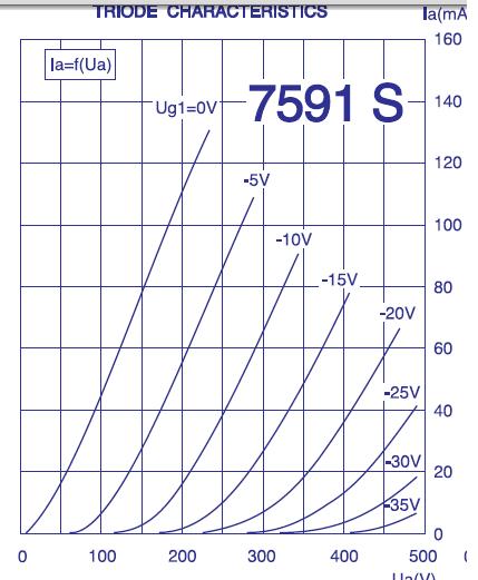

Lars,
I did some playing around with the spreadsheet this morning and it does work. The values of the spreasheet are the same I get from doing the manual charts. I also see that you did use the multiplier of 4 to calculate the slope of the loadline from the input RLa-a cell. This was my initial question and it seems it has been confirmed.
I notice the Negative Feedback cells. How does it work? If I take the feedback from the 16ohm tap then I put 16 on the cell? You have R1 and R2. I assume this is for a voltage divider. If the design does not call for two resitors, then R1 is 1ohm like in your default value? This negative feedback currently does not affect the calculation of output power, shouldn't it?
Alfredo
Hi Alfredo,
Glad you gave it a chance. A useful gadget is the possibility to see A and AB power. If you want to go all Class-A (recommended) just let the two lines intersect at Ug=0V. I also recommend you triodewire the tetrodes if you are going to use it for HiFi, see curves below. Ua425V, Iq45mA, Rl 10k, will give you just above 10W.
About the feedback cell it is for getting the sensitivity of your amp at the input of the PI. So no feedback is R1 small and R2 big. And off course it does not affect output power.
If you go triode you will not need any NFB. Tetrodes need fedback but I would not recommend more then ca 12dB.
Also noticed you are using 7591, great tubes! I am using them in my "reVintage Pro" guitar amp.
