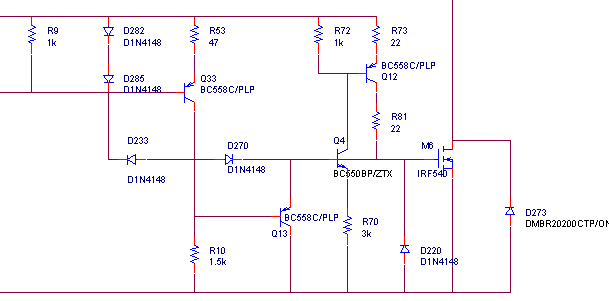

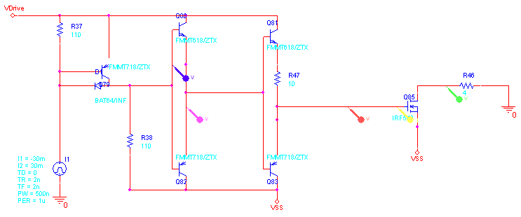

Here's one I've been playing with.
Hi Chris,
As a recommendation, move R47 to the first EF pair – this will allow the second pair to offer a lower impedance to the Reverse Miller Charge. To this end, Q80 need only be a cheaper BC something…
Due to the EF voltage drops – you will probably need to Capacitor couple the Gate Drive, and return the Gate to nearer 0 volts. As FETs heat up, Vth reduces…

Hi John,
Would you only change q80 and leave q81 as is, just to add the "soft" dead time etc. Or change them both? I know keeping them all matched doesn't really matter but it's something I have to talk myself into 🙂 Though, I had tried that many many posts ago and it simulated exceptionally well.
I love the idea of 0Vgs ability but.. the only way I can think of actually making capacitive coupling work envolves adding another resistor from gate to source, after the cap, otherwise gate voltage is no longer with respect to source. Then we have higher impedance seen by the miller charge again. Is there another way to do it?
I've seen other ways of generating even negative gate drive, type of charge pump, might look into that but I'm not sure how good it would be.

The “killer” in switching Fets is Toff Delay. Ideally, you want as low pull-down impendence (fast) as you can (Toff), and have a “Soft” rising edge (Ton Gate drive) – but the reverse miller charge is also a problem – so the best solution is to have slower but low impedance rising edge, and a fast and low impedance as possible falling edge. That’s why its better to have the “soft” rise-time resistor in the proceeding EF pair – to a degree, the final stage EF’s provide a low impedance – slower rising edge and “buffer” the reverse Miller charge.
Inserting the resistor in the Emitter “unbalances” the circuit, so you might as well just us a lower current / gain device anyway.
Yes, you need to DC restore the Gate drive signal after AC coupling (Schottky & resistor), but the impedance of the Gate drive will not be adversely effected by the insertion of the capacitor – provided it has good RF qualities – I use “reverse format” types – 0612.
Another method to DC restore is to add a Zener diode across the coupling cap.

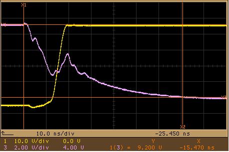

Thanks, John, I'm sure that will give a good boost to alot of people.
My question is can the bjt followers take care of the miller charge, through the cap, without the 47kohm resistors causing a significant amount of gate step? Also, if so, would it hold true for even higher rails?

Hi Chris,
The 47K resistor function is only to keep the Gate "OFF" with no drive signal – DC restoration is performed by the Schottky diode. The reverse miller charge is an AC phenomenon, which is held into check by the low impedance return path to the driver stage.
Looking at the Pch device, the reverse Miller charge is coupled back into the driver stage via THREE capacitors! The first, the Gate capacitor, then the cap from HBridge to Positive driver supply, then lastly the Cap. from the Positive driver supply to Ground!
Where there is significant Miller Charge (such as with the Si7414DN), I couple the EF’s supply decoupling capacitor directly to the Source of the Output FET via 2 capacitors to allow the lowest impedance path in BOTH directions. One capacitor path for the Reverse Miller charge (connected to EF pair’s Ground connection), and the second to allow rapid Toff discharge (to the EF pair’s Positive supply). Decoupling capacitors are connected directly across the supply rails to the EF pair’s, level shift Fets & 04 inverters – which are not shown on the circuit diagrams for clarity.
I tend to always see a greater reverse Miller charge “spike” with the Nch devices, I believe this is due to there Lower Gate resistance (about 2.5 to 3 times lower then Pch devices). In the Pch devices, I believe their higher internal Gate resistance dissipates some of the “Spikes” energy – but this is only a “John’s - back of the mind theory”… However, the truth may lay somewhere else!
