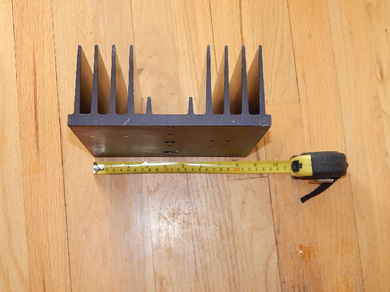

I'll be using 2 pieces of heatsink for each channel - see attached pic for the profile of each piece.
I'd prefer to put each output device on the part of the sink with the longer fins.
put devices in middle (by width) and ditto on lower third* (by height)
there is proper base thickness to spread heat evenly on fins
*that would be on 33% height , going from bottom

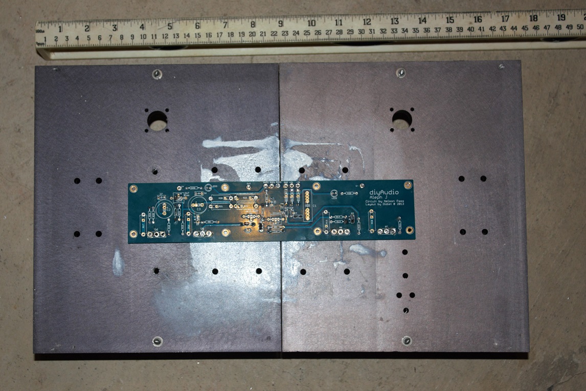

Hi VictoriaGuy,
I think I have very similar (if not the same) heatsinks. Here's a picture
of a pair with an Aleph-J board to give you an idea of the placement
of the mosfets.
Dennis
Thanks, Dennis-
Certainly pertinent to my question - great picture which shows the board and sinks.
Yes they are the same heatsinks - from a govt surplus VHF amplifier?
Did you use 4 of them - two per channel?
How did they work out?
And what's the temperature of your amp when operating?
I'm thinking I might be able to cut down the height a bit, but I'd feel very foolish if that resulted in overheating....
