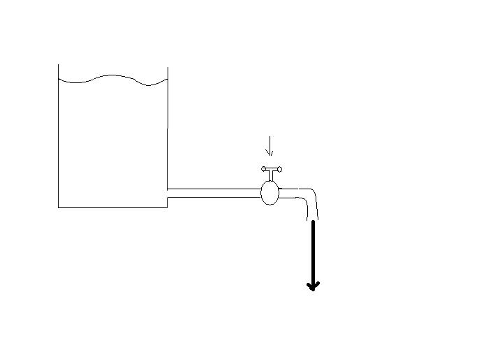

To make an hydraulic analogy:
The psu caps are the tank and the faucet the amplifier.
The waves at the surface does not affect so much what flows from the faucet. The faucet only controls the flow.
The quality of the tank is not very important.

the quality of the tank is important isn't it ? we are talking about distortion from capacitors which means that the capacitors impedance isn't a simple 1/C dependence - meaning the 'tank' affects the flow of water ??
This visual comparison (hydraulic analogy - as you say) I hear from many manufacturers (respective their developers) that use cheap ps capacitors in their expensive audio amplifier devices. They justify the use of such low-cost capacitors very happy with it.
If there are amplifier circuit topologies with nearly perfect supply voltage suppression character - according opinion of the developers - brand and quality class of supply caps doesn't matter. But until this day nobody was able to demonstate me such amp resp. such circuit topology.
If you find such commercial power amps with a great amount of not used space in the height (there are enough brands and models), it is an easy task to replace such caps with computer grade versions. After done this and after soundcheck you will note, that the mentioned hydraulic analogy isn't right.
BTW: If the psu caps the tank, what are here the parasitic elements (inductors, dielectric and frequency dependend effects) ??
If there are only DC conditions (e. g. by chargers), then the visual comparison is reasonable (and the quality of the tank is indeed not very important).
