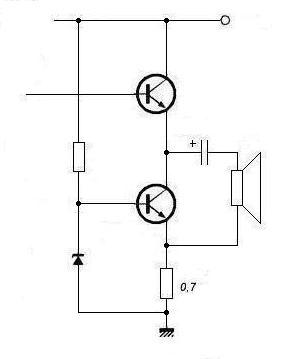

would like to explore the differnt topologies for output buffers that per example can be driven with a tube voltage stage...
I know of the types consisting of simple mosfet follower driven in Class a or a/b....but the types are typically without feecback and based on mosfets....
The one i have in mind.....must have...
gain of 1
high damping factor
scalable
high input z (easy load)
Btj output devices
anyone with a suitable concept...???

That must be voltage follower, I have many version, but all mosfets outputs with floating drivers. I ever trying with bjt and not success. I don't have any no feedback, but all with local and global feedback.
Why not just using multi stage emitter follower? or cascoded one?

I posted a schematic of PP buffer here, asking for further pointers and/or alternatives. I went with a version very similar to what I posted in the end and it works perfectly. I have updated schematic somewhere. I used tube front end (6N3P) to drive the 0 dB gain output stage.
As for your requirements: first two fall under same category (add more output devices and adjust drive accordingly), third is a matter of adding another follower to the input if you dislike the existing solution and the latter is a matter of choice (I used BJT integrated darlingtons that many denizens of this forum will shun even though they work just fine). Zero GNFB in the amplifier. Some call it "Zen", others bash it 😛

It's just an emitter follower riding on a simple CCS (LED + BJT), with adjustable Vbe multiplier between the bases of output darlingtons. The rest is the usual stuff, Boucherot cell and small coil wound on 10R at the output, capacitor coupled output.
