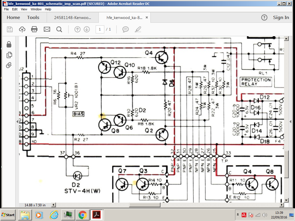

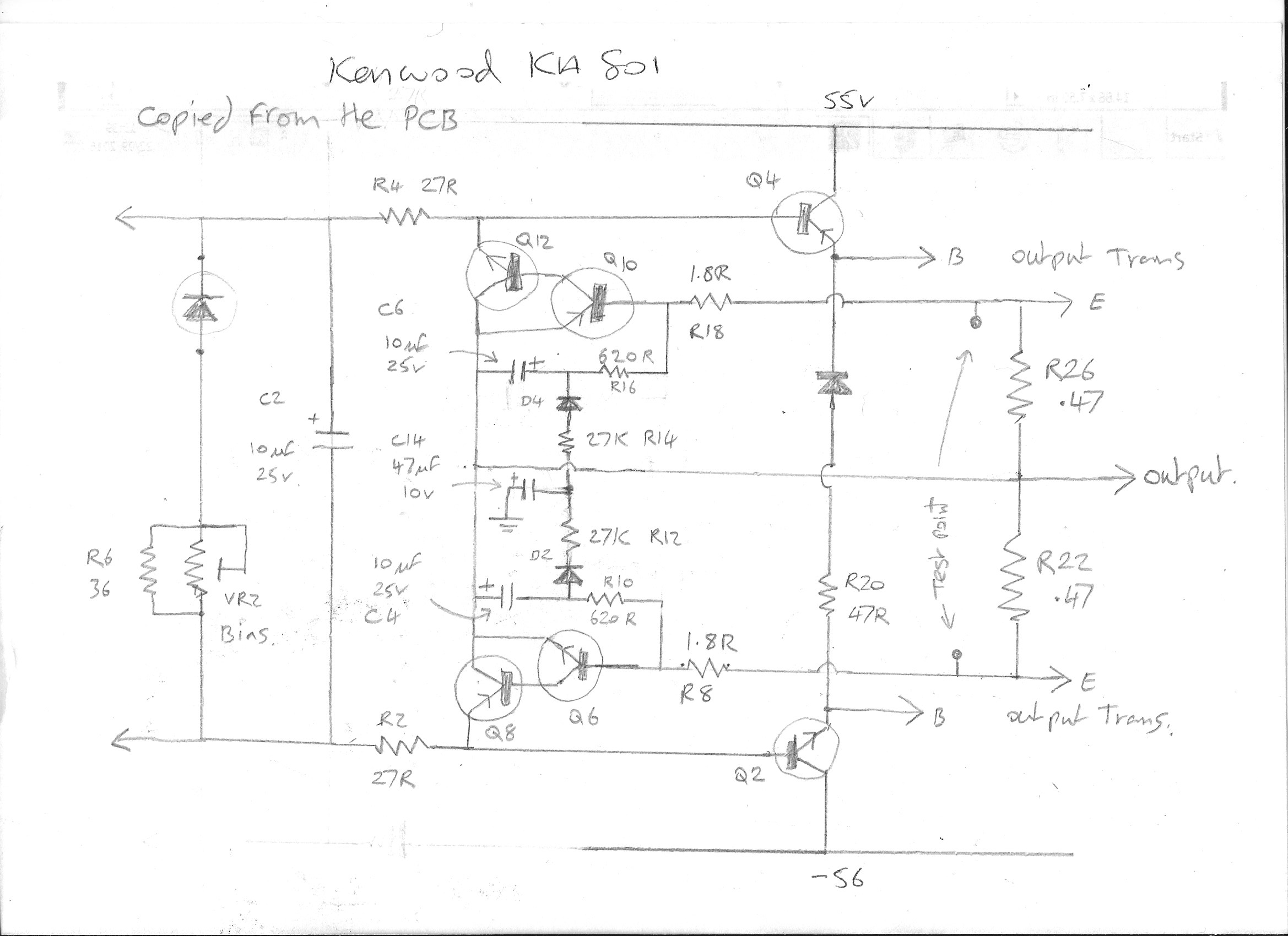

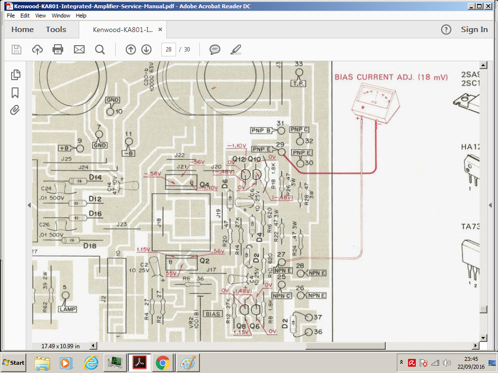

I noticed from looking at a images of other Kenwood KA 801 amps that some of the them had less components in the power amp stage than mine did and not only that they are shown in the service manual in the section displaying the foil tracks and component layout but they are not shown on the schematic.
I have scanned a pencil drawing that i have copied from the PCB layout a screen shot of the PCB and the service manual schmatic
The components not shown on the schematic are;
C2 (10uf,25v)
C4 (10uf,25v)
C6 (10uf,25v)
C14 (47uf,10)
D2
D4
R12 (27k)
R14 (27k)

Q10,12 and Q6,8 form active current limiters which restrict the output of the power transistors to within their SOA limits. They are safety circuits incorporated in but not considered part of the power amplifier itself. Usually they require extensive field testing to ensure they work effectively without noticeably affecting the audio. It would seem like there was a problem there and it was addressed by those mods at some point in the model's production lifetime.
It's normal to see minor revisions to models but of course, if you weren't a service tech back then, you wouldn't receive updates. It's history though and the supporting documentation for many such ancient models is now unobtanium.
C2 is something I was surprised not to see on the original as bypassing the vbe generator (R + diode) is pretty standard practice and can help with high frequency performance/distortion, particularly with regard to ensuring the driver stage can turn 'off' quickly.
The R's and C's added to the current limiter modify the basic characteristic making it less prone to cut in to enthusiastically, perhaps when faced with a more challenging load such as a speaker with a reactive and low impedance.

you have swapped your supply rails.
The middle sch has -ve at the top, your version has +ve at the top.
