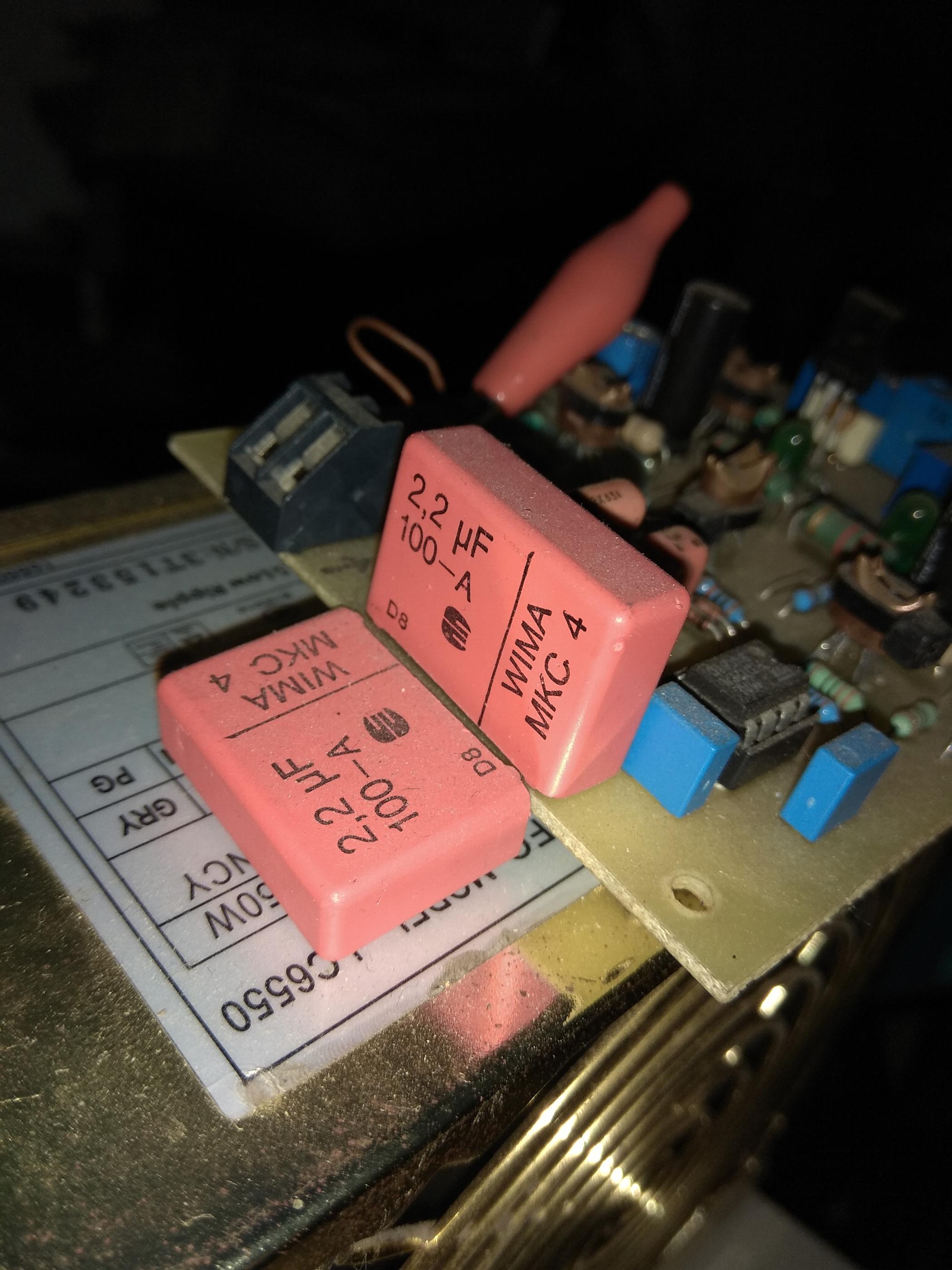

Calvin, thanks for re-confirming my earlier remarks.
By the way, are there any capacitors using a winding technique where the outer ends of the foils are half-turn apart from each other? Then there won't be "inner" and "outer", both foils will be outer.
could explain in a more precise way😱 ?Empirically: hold the capacitor in your hand and touch each lead to the input of an audio amplifier. Higher hum belongs to the outer foil.
thank you
It is difficult to clarify a sentence which already seems extremely clear.
Anyway, for 3.9uF this test is unnecessary. 'Outer foil' is only relevant when the cap has a low enough value that stray capacitance to the outer is not entirely negligible when compared to the cap value. We are speaking nF, not uF.
they don't usually has an outer foil and cut equally, just connect one lead to the package and it is outer then.
I had hum using this capacitor as input coupling cap.
Reversing this hum was gone.
Outer side is marked in this case.
A logical way to test a capacitor foil is to connect one lead to ground, one to a signal, and sense the field around the cap capacitively. Then reverse the connections. Whichever way round has the highest sensed field has the outer foil connected to the signal.
This method will work whatever the capacitance value (so long as the signal generator can drive that capacitance at the frequency used - use a low frequency distiguishable from mains).
But a fairly sensitive high-impedance probe is needed.
One likely reason for cap foil orientation in vintage amps was related to the input stage pentode screen bypass cap - a relative elephant amongst other parts, especially when shoe-horned in to a tight chassis. Having that physically large outer surface sitting at ground, rather than at screen signal, may have been a benefit for nearby parts and terminals/wires that often were touching the outer casing of the cap. Those caps were often closer to a uF than a nF.
