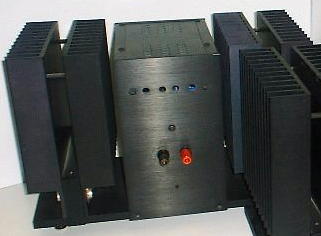

This is probably the best place for a crossover and when I was building my first A75 monoblocks I put the crossovers right in the amp (in a top part). You can see on a pic 6 holes for 3 outputs. Later when I decided to sell the amp, I converted to regular output.
I was experimenting with my DAC recently and the kind of feet and the way they positioned under the chassis play big role in the sonics, so how could it be, that locating the crossover wouldn't affect the final sound?😉
