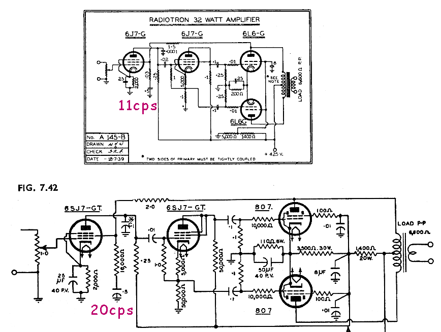

....The circuit from HB3 is frequency selective to achieve a roll off in the audio range....
I am not sure what you mean. I do not see audio frequency selectivity in these plans. 20cps-11cps is far below the state of common loudspeakers of the 1930s and into the 1940s.

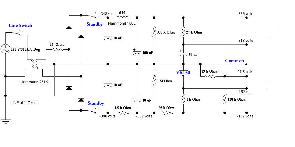

I used all those extra power sources in the schematic in order to simplify the result. Otherwise the schema got too crowded, difficult to see what was real or not. The on board PS as used is attached here.

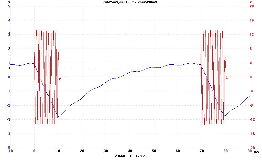

One of the objectives of the amp was to test its response on a limited PS. The Hammond 271X is on the small side but seems OK at steady state. The PS response to a pulsed 10 watt load is also attached. The B+ drops ~3.5V (red trace) & then recovers.🙂
