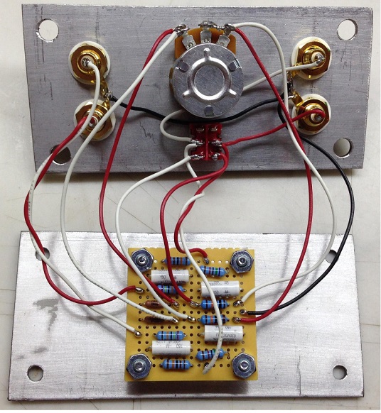

I built a simple breadboard circuit that was detailed on the Bottlehead forum several years ago that worked quite well, although I've never heard a commercial product to compare it to.
