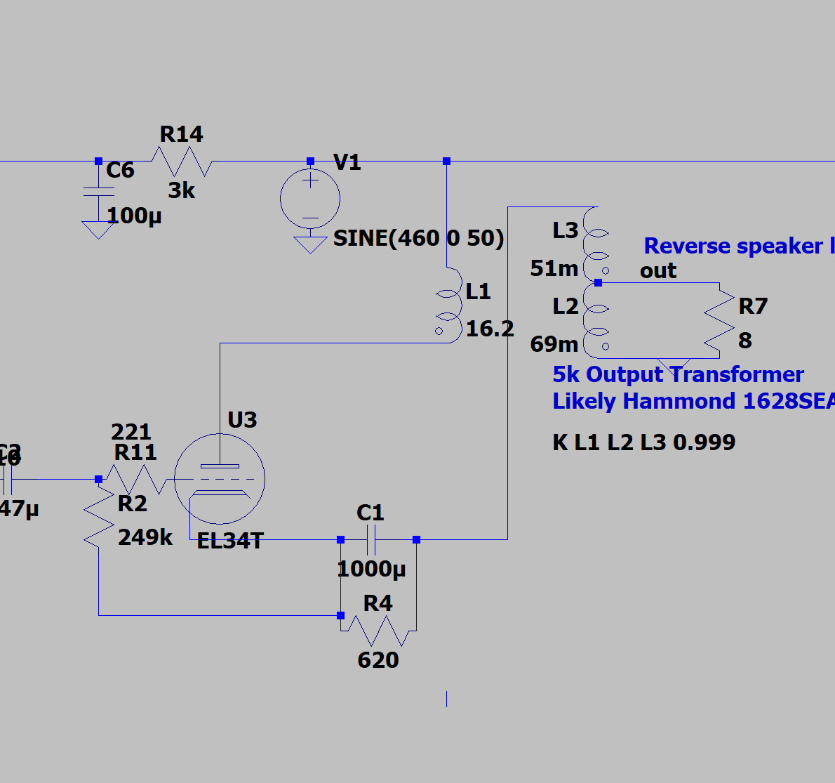

Hi All,
In the image below I present two kinds of local feedback typically seen on pentode output stages. I am currently using cathode feedback with great results, but the Schade Feedback intrigues me. What are the pros and cons of each method?
Many thanks,

Been doing some simulations.... With typical high gain input tubes with high plate resistance and running a few mA, Schade doesn't seem to have much current drive at high frequency for large output tubes. Would that be a correct observation?
Cathode feedback is series-applied voltage feedback. The other would be parallel-applied voltage feedback but I would quibble with calling it "Schade" because O. H. Schade used series-applied voltage feedback in his paper (using an interstage transformer).

Sorry I wasn't clear. What I meant was that if you have, say a 12AX7 input stage driving a KT88 output stage, all the various impedances with the parallel feedback method don't seem to allow the KT88 to be driven properly at high frequency. It's not a shortfall of the feedback method itself, more a problem with the implementation using common tubes without an intermediate driver stage.

To get back to your question: A transformer introduces distortion, mainly H2. Cathode feedback minimizes the distortion but you have to use tubes that are high Gm (EL84 / EL34 / 7591) and not tubes that use high amounts of drive like the KTxx / 6L6 etc.
Schade feedback keeps the transformer out of the loop, some people like the sound of that in small amplifiers. You'll have to realise that 2% H2 distortion of 30 Hz being at 60 Hz sounds louder than the fundamental 30Hz.

Well, with parallel-applied feedback, the driver is working into a much more vertical load. You want to find a tube that will be most linear when operated that way. Pentodes tend to be a better choice.
I think you could come up with a tube combo that would do the job well. I did it once with a p-channel fet follower and a resistor-divider. See this blog post for more info.

So something like this instead (using a triode for schematic simplicity)?

Voltage sensing negative feedback applied in series with signal increases voltage drive required by the amount of feedback. Voltage sensing negative feedback applied in parallel with signal ("Schade") increases current required from the driver by the amount of feedback. Second Law is inviolate.
For most practical amps, the amount of feedback voltage available from the output transformer's secondary is so small compared to output stage signal voltage as to not really matter - maybe a coupla dB, tops. But can't hurt, free, no harm, no foul.
I think many folks tend to underestimate the burden that "Schade" feedback places on the driver stage. A useful way to estimate it is to think of it as if it were Miller capacitance - it works exactly the same way and for the same reason. It's otherwise elegant, thus attractive, but does need to be considered. And it's the only way to derive a voltage sensing negative feedback from a simple single-winding primary and to apply it over only one stage (RC coupling assumed).
Deriving the sensing voltage from the primary is good for transformer distortion mitigation and for stability, and places the feedback around the highest distortion stage, if all else is well designed. All good stuff, but places a burden on the driver stage (Second Law). Fortunately for us, that stage has very well defined job requirements, and can be made arbitrarily close to perfect, which is not true for output stages.

In your schematic the grid resistor of 249K is connected to the cathode, which would mean there's no bias. It should be connected to ground. If you want to also apply GNFB to the stage preceeding the power stage, the secondary should be grounded at the point where L3 and L2 connect, so not at the bottom of L2. The GNFB can than be taken from the bottom of L2.
If I'm not mistaken, connecting the resistor of 249K to the other side of R4 and C1 would create cathode bias but would undo most of the cathode feedback.
Oops, you're right. I made the schematic in a hurry and missed that!
Ah yes I can see how that would work. Not a bad way to linearise the output and input but keep the overall GFB factor a bit lower and maintain stability. Great suggestion!
Regarding your last comment, perhaps this is why the tubelab SSE does it differently. This is the way I have my current amp set up and it seems to work well without any obvious instability.
