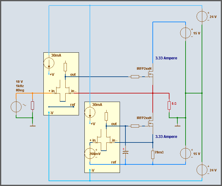

I decided to go for 2x12 VAC toroid trafo.
For the Follower, The HEXFET Class A output BLOCK.
I use +-15 Volt in my Test Circuit.
The real life value may be 15-17 VDC something, very much dependent on TRAFO Size
and also rectifier and PSU filtering technique.
To make output stage
- have higher effiency and
- 4 Volt Gate-SOURCE stay uneffected by output voltage/current levels
.. I use my floating MOSFET Driver Modules.
( Yellow in my figure below )
Biased from The +- 24 VDC supply, that powers the BLOCK1 Voltage amp, too.
I have used Op-Amp style to show the Equivalent operation of my modules.
As this is somthing most diyAudio members can relate to and understand.
I do not write for only the Audio Engineers at our forum
and those with high technical terms and the amplifier university mumbo jumbo langauge.
Probably they have use those words/terms, when publish their patents and white, red or blue papers rated 5 stars out of 5 😕
Equivalent.
Means for examples, there is in reality only one 2SK170GR N-JFET for 'op-amp' input.
Modules are supplied by 30mA (N-JFET based) CCS, constant current source.
I will not now go into the technical aspects, why I did it like this.
Okay.
Here you are.
My Output BLOCK2. To show the Basic setup I use.
In colours layout
to make your eyes easily see what is going on.
lineup - regards from Sweden

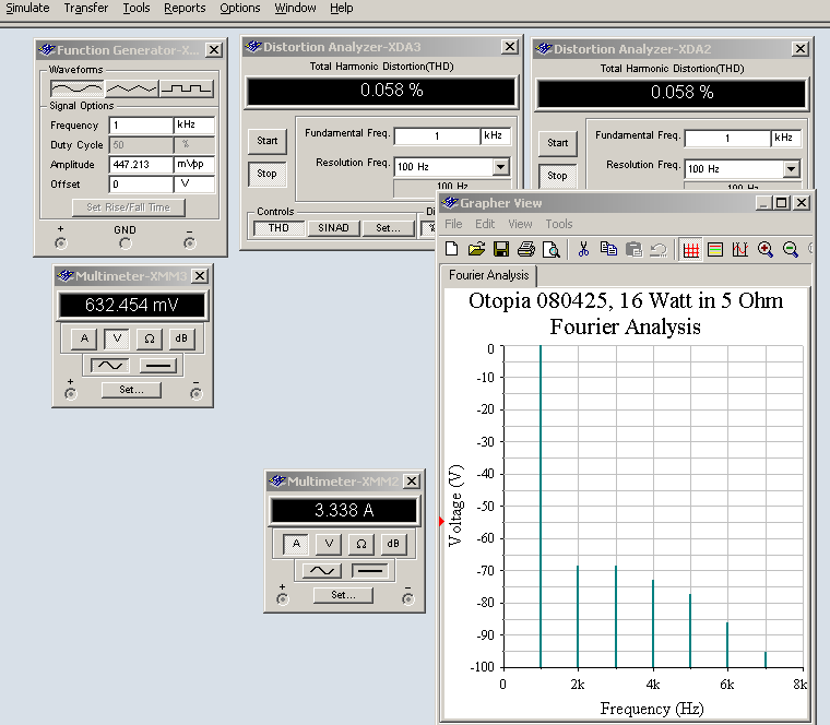

2008-04-25 Otopia Project Status Report.
The output stage with my special HEXFET Drivers shows excellent data.
I mentioned in an earlier post, that the output BLOCK2
has got very low impedance.
Today I measured this, at several output levels.
where output BLOCK adds practically no % THD,
to what the first BLOCK (Voltage amplifier +23dB) contributes.
THD is ~ 0.058% at Power Input, as well as Output
For 16 CLASS A Watts RMS into 5 Ohm.
The Power Amplifier block looks like having several 100 kOhm input impedance.
Of course by the fact it has got 2SK170 JFET input transistor ...
But I am not 100% sure what is best method to test / calculate input impedance.
Anybody have some hints for me 😕
I would be glad to know how you estimate input impedance of your power amplifiers.
thanks 🙂
For one of today's tests .... with Fast Fourier harmonics
See attachment, please.
Regards 🙂

a quick and dirty way i've done input impedance at a specific frequency was: hang a large pot set to zero resistance in series with the signal generator's input to the amp. turn the pot until the circuit under test output drops to half. measure the pot - that's the circuit's input impedance at the test frequency.
not the most accurate, but it's quick

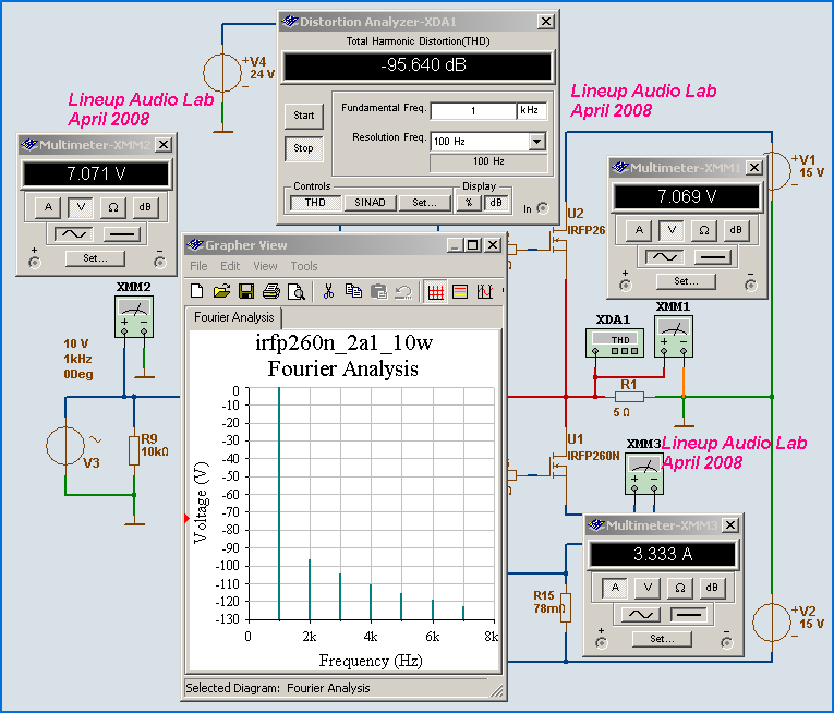

IRFP260N Class A output stage FINAL
A final teaser for a few of my friends only.
As can be seen Class A output consumes 100 Watt.
This test today shows a 10V peak output across 5 Ohm.
This means 10 W-rms pure single end Class A. ( +10 dB on speakers )
The max output is closer to 20 Watt RMS ( 14 Volt peak )
IRFP260N has got a RDSon ~ 0.04 Ohm.
And is a TO247AC HEXFET rated 300 Watt.
After now finished output stage, I will now put all efforts
to finish My JFET input / voltage amplifier.
....... so it can match my power output circuit 🙂 .......

This is a totally irrelevant parameter in a class A stage. It's only important when the mosfet is saturated like in switching applications.lineup said:
You haven't actually shown us anything so we probably don't know if we should miss anything.lineup said:
