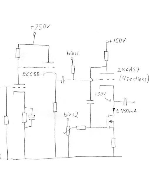

OTL but not OCL!
Here´s a conceptual schematic of what I´m rambling about.
IF I´m going to build something like this (likely, since I have most of the parts in the junkbox) it will be for the purpose of driving the mid/high section in my dipoles.
Because of this the output coupling caps can be quite small, so film types or PiO´s are not out of question.
That should work.
Have you calculated the Zout?
Personally I'd use both sections of the 6AS7G iso the FET, but that may require some matching to balance nicely.
This type of circuit could also do away with the coupling cap at the output but the feedback cap will have to stay.
So that may just as well remain an exercise of theoretical application.
Cheers,😉

No calculations, just a conceptual schematic.
I think the Fet might be a good idea, (unless someone´s allergic to silicon😀 ) since it requires a lot less input signal compared to a 6AS7, which means we can use a smaller resistor on top of the cathode follower. Correct me if I´m wrong here.
A bot of NFB might be useful to tame the output impedance, but OTOH; open baffles might like a bit of output impedance?!?

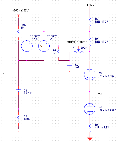

Hi, fuling -
Perhaps you could get enough in phase gain by cathode driving a, say, miniature triode from near the +150 and a higher supply to allow a more reasonable value for the WF upper plate resistor so as to lose the MOSFET. Maybe you could even manage the grid bias connection for the gain tube by splitting the WF upper plate resistor and filtering the signal component out.
I'm afraid I'll have to get shots now for audio silicosis
Let´s see if I got this one straight:
The ECC88 amplifies the signal that develops across the current sensing resistor so it can drive the lower 6AS7, right?
Clever, I must say.
Still, this means I have to double up the number of output tubes since half of them gets "lost" in the active load.
Since I´m not "afraid" of Mosfets I think I´ll go for one in the lower position, partly because I have only four 6AS7´s at home and my filament transformer can´t handle anymore.
So far this is only a "for fun" project and I don´t want to spend any money until I´ve seen some positive results.
Who knows what it develops into?

Hi, Fuling -
That's correct. The output z trim might allow you to possibly achieve a damping factor more comparable to some global feedback amps, also. Don't know this for sure since I just sketched it up, but I don't know why it wouldn't work that way. If only half the miniature dual triode is needed for this (adjust plate resistor to match), perhaps the other half is all the input and driver stage you'd need. Could maybe even be a global feedbackless two tube (or three tube, if 6C33C's used) OTL then, if only one PP class a 6AS7G or 6336 meets the power requirement at hand😎
