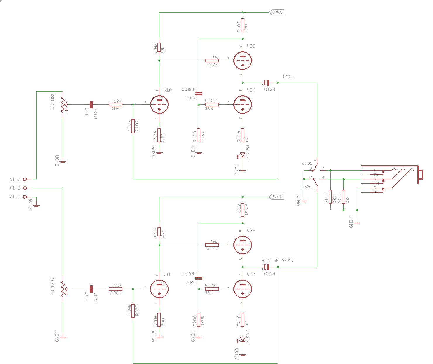

Sharing time. I recently finished the build of my third OTL headphone amp. First one had a SS output with tube input, second was a SRPP+ build. Latest is an ECC99 White cathode follower output with a 12AT7 as input tube. It's loosly based on the 'Morgan Jones' headphone amp, with lots of tweaked resistor values, alterations to accommodate the ECC99's and some other things. The WCF is partly LED, partly resistor biased as a compromise between distortion, dissipation and output. HT and the input tube's heater are regulated, the ECC99 heater's are AC, mainly to the current demand.
Some measured figures. All into 47 ohms resistive load @ 1kHz (if applicable):
THD: 0.017%
THD+N: 0.96% (needs work)
Output impedance: 5.6 ohm
Freq response @ 20Hz: -0.065dB
Oh yeah, and it sounds awesome!
It's still a 'prototype' so no enclosure will be build. So I had to find something that was cheap, available and easy to work with. LEGO! I still have loads lying around, it's an electrical insulator, and can stand some heat. Perfect. I felt like a child again, sore knees and all :D
The pic with the open enclosure is (obviously) with temporary output caps.

Good point! I forgot to mention the levels. The THD and THD+N were measured at 1Khz with 300 mVpp output, into a 47 ohm resistive load. At 1Vpp output, the THD rises to about 0.1%, but than the SPL in my AKG 271 is deafening. THD+N decreases to around 0.6%/0.7% with the higher output.
I measured the output impedance with the load /no load method. I used a 1kHz signal again into a 47 resistive load and measured the two different waveforms on my scope. Zout = ((Vnoload - Vload) / Vload) * Rload. And it agrees with the LTSpice simulation.
Edit: One thing I forgot (it was late, long day and all that), was the current absence of the input caps. Low end frequency will be reduced slightly when they're fitted (still in the mail). That way, I'll let the input polyprops set the frequency response instead of the output electrolytics.

Excellent. That mkes sense. The THD+Nmeasurements are puzzling though. Do you think there is a noise problem? Perhaps the cathode LED?

Yes, the THD+N needs some work. There's a fairly large 50Hz component in there which accounts for most of the noise, so I don't suspect the LED's at this time for the rather high value. Higher frequency noise is at immeasurable (for me) levels. So I'll have to find out where it's coming from. The transformer (toroid) is all the way in the back, as is any mains wiring or on-off switch, so EMI seems unlikely. I do have some ideas concerning grounding but any suggestions are welcome off course.

Ah, good old hum. The first thing to check is that the heaters are connected to 0V at some point. Do you have elevated heaters? With topologies like the White follower, the top triode's cathode is way above ground. This can mean its Vhk is exceeded. The usual way to fix this is to raise the heaters to 75V or so above ground. My ECC99 SRPP based headphones amp runs on ac heaters without hum so there should be no need to use dc heaters.
I am not sure what the PSRR of the White follower is but there is a fairly easy path for HT noise from the top resistor straight to the grid of the bottom triode so maybe the HT needs to be particularly clean.
By the way, what plate current is the ECC99 running at?

Using a 12ax7 in the first stage (and dropping the plate current to say .5-1ma) will give you more open loop gain which will help with the THD. So will bypassing the cathode resistor on the first stage. Making the top 220R on the ECC99 to 330R may also null out the second harmonic. Glad it works well. Like the LEGO.

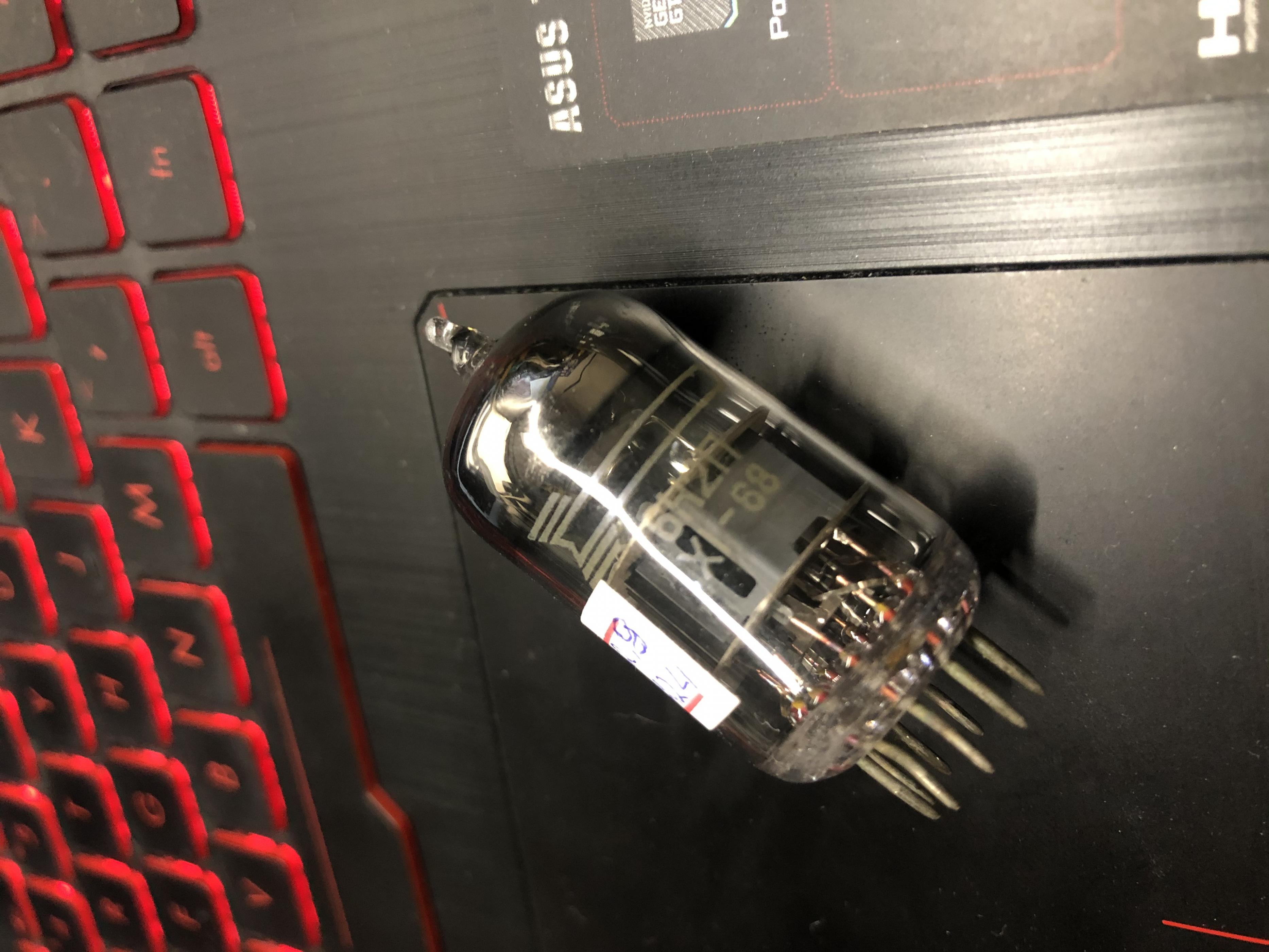

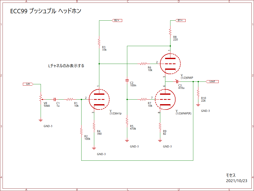

I ended up with using Soviet 6N2P in the first stage which is quite similar to 12AX7 but with 6.3v filament voltage.
It has a NFB loop which sets the gain to 100k/10k = 10. I don't know if I can increase gain by bypassing cathode without changing value of NFB. Could someone explain how this works?

The NFB gain is = 100K / (10K | VR) so it will vary with volume. VR is the parallel combined impedance of the pot to ground and the pot through the input signal path. U
sually a gain of 3x is good for headphone amps. Normally you would make R1 say twice the pot value so this effect is minimized. The closed loop gain will approach the ratio of the resistors when the open loop gain is large. Increasing open loop gain may affect stability but this is not normally a problem for a simple dominate pole which is what you have. NFB will only help if the output stage has enough drive at the output string not clip.

True. I was thinking that lowering the R5 value means the 12AX7 sees a lower value too.
The 12AX7 is DC coupled to the cathode follower stage, so it only 'sees' the grid of the ECC99 and not R5 for example.
