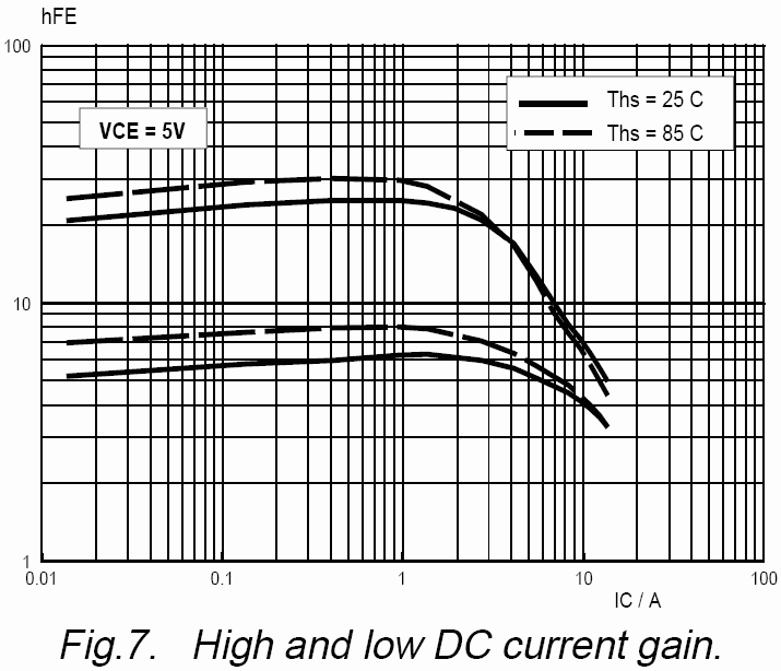

http://www.nxp.com/acrobat/datasheets/BU4525AX_3.pdf
This is the same part as used? Correct datasheet? True?
For "middle of the graph" Triodlington current of 75mA:
Current gain drifts aproximately from 6.5 to 26.5
over a temperature range of 25C to 85C.
But I only tell prokies, whatever the heck that is...
And so does Phillips.
I merely suggest that holding the temperature constant
at 85C might be easier to regulate than holding at 25C.
Its a fine circuit so long as Beta is not permitted to drift.
kenpeter said:I do not require anyone to believe.
I hope the other forum members are able to read this graph.
Darius is correct, and I have completely misread the graph.
Drift within stated temperature range is only 4.5 to 6.5,
or 22 to 29. Depending what random batch you got...
