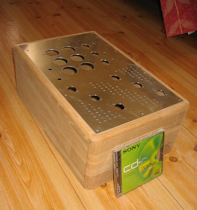

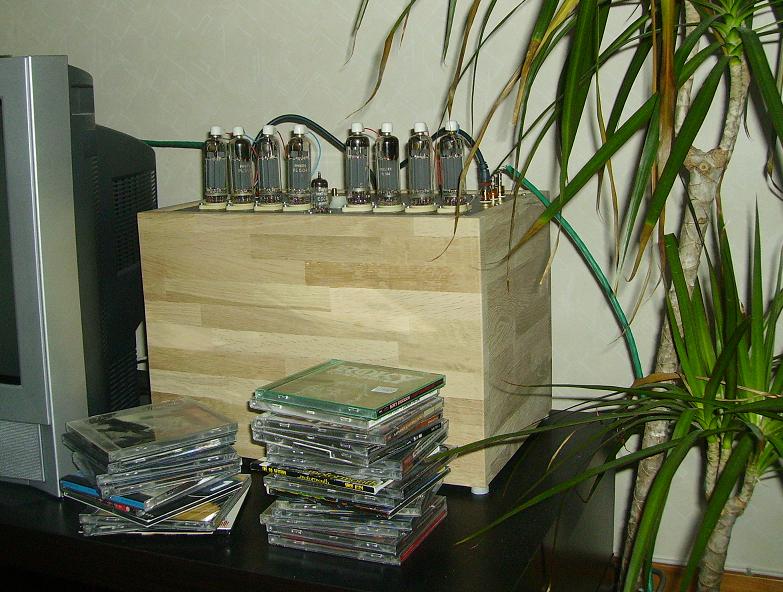

Very nice cabinet too, if I may add. Do you have anything inside, like a speaker, etc., or just using it as a base?
Thank you!
I could have made the enclosure 2-3" lower, but I wanted to use the full width of those oak boards.
The cathode chokes and PSU takes up a lot of space.

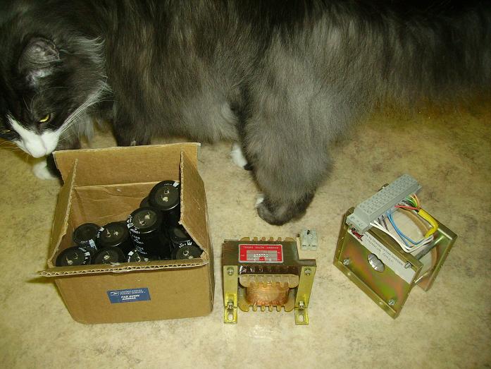

I´ve been quite lucky sourcing parts for my new OTL.
The PSU caps costed 5 bucks at Ebay and I´ve found toroid transformers with all the voltages I need except output stage B+ at local surplus stores.
This picture also show the reason I don´t want to use tubes with top caps, that cat costed more than the budget of this amp...

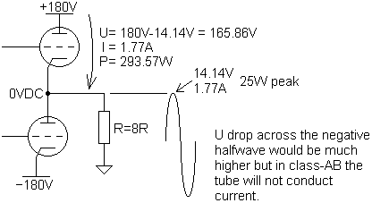

I’m trying to educate myself on these OTL amplifier circuits and instead of creating a new thread I decided to revive this one as the title seems quite appropriate for questions…
The biggest headache I have in understanding these circuits is this one:
Feeding peak power of 25 watts to an 8-ohm load requires a current of about 1.77A and a voltage of about 14.14V. (I rounded the exact values). A typical push-pull OTL output stage is powered from a dual supply rail having about 180V per each side. This means 165.86V voltage drop across the tube during the signal peak (when feeding 25W to 8 ohms). Since 1.77A flows through the tube, the tube must dissipate 293 watts, right?
Most tubes suitable for OTL amps seem to have a maximum plate dissipation of maybe 30 watts. What is it that I don’t understand in this equation?

In class A, you're right, the dissipation is HUGE. But most of these amps run in AB, where the efficiencies are somewhat better. They are still pretty wasteful, though, and typically you'll see several tubes in parallel even for a relatively modest 25W at 8 ohms.
Yes. And paralleling output devices is also good for lowering the output Z. But for example, some of the designs out there claim 25W (I assume average) to 8 ohms and use only a single pair of 6C33C in push-pull. If my math is correct the claim for such output power does not seem realistic. Even if you had 8 6C33C in total (4 per each side) each tube would still dissipate about 73 watts - and that if the 25 watts to 8 ohms was the peak power rating! I’m wondering if I just have misunderstood something.
If someone claims that they get 25W/8ohm in class A OTL from a single pair of 6C33, they are delusional.
Efficiency goes up as you parallel tubes (up to a point). In transformer coupled the power potential doubles when paralleling. In an OTL it will quadruple the potential power output. This is because your current capability has doubled. Current is pretty much the limiting factor for OTL's with lower tube counts. Of course, overall power consumption is large with an OTL.
20Wrms is common power output with one pair of 6c33c in class AB. 80Wrms is common for two pairs in class AB. Your amplifier will consume twice as much with 2pairs but it will be putting out 4 times as much. Remember that the 6c33c's current rating of 600mA is continuous DC. Peak current is much higher, which is why class AB is the better route.
Most OTL manufactures claims are false. You can tell by the specs they are either lying about the power output or the fact it's class A (ok, maybe the first portion of a watt is).
