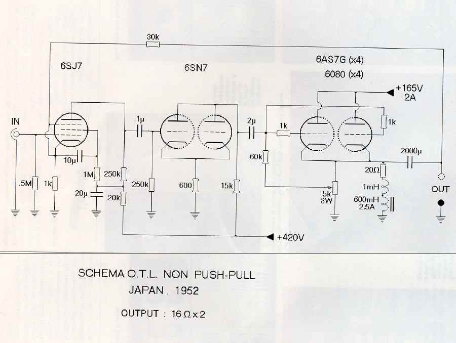

That DOES seem easy to build. 3W distorted with one tube into an 8-ohm load should mean that I'll get at least a good 30W with four tubes into a 64-ohm load. I wonder if I could use the other half of the 12AX7 to get a bit of gain?
astouffer said:OTL amps are not really projects for people who haven't worked with tube circuits before. If one tube decides to short you better have fast blow fuses because your speakers won't last very long.
But here is a circuit that is simple and does not need a split power supply.
That's a single-ended amp. It's not going to be nearly powerful enough for my purposes.

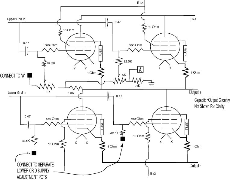

Frank what do you think about this mod for the Futt or the NYAL OTL 3?
The output cap network is not shown so the pic is clear obviously that would go back in at actual build time. The lower grids have their own power supply off of the PT so I would split that at the resistor before the control pot in that supply and then just double every going out from there as you would do say in any push pull amp which had a single supply for the output tubes.
On the upper grids it is shown clear what I believe will work.
The reason for this is that it is so difficult to get matched output tubes these days for the 6FW5's, 6BH5's & the 6LF6's that this should allow for separate adjustments for each unless I am missing something.
Any comments?
Thanks!!
