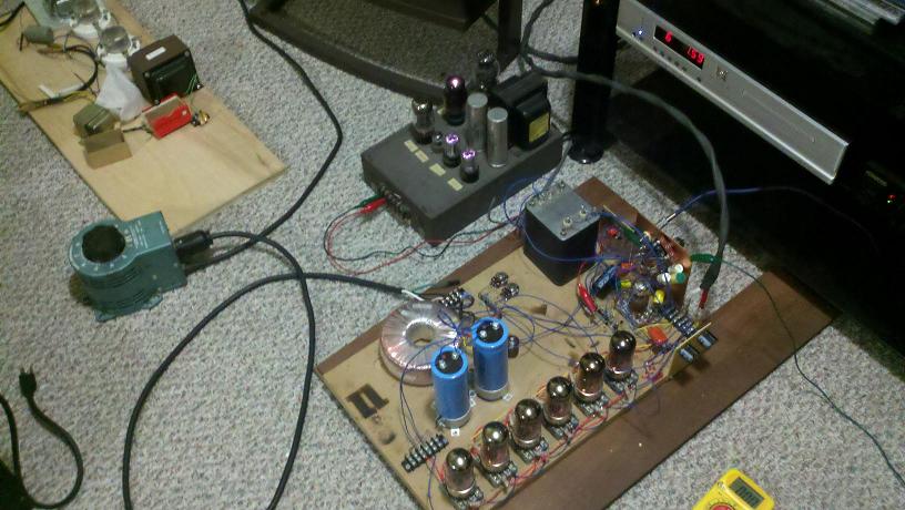

I just built this amp. Started listening last night. Very nice sound, nice and clean with nice mids. Although I am not a fan of the 12AX7 overall in this design she is not coming across as bright as the most recent OTL I built which you cab find in this thread:

Here is the last page of the article and my testing rig build up. The power supply in the pic that is at the top center is a regulated PS that is running the 450vdc lines. The 155 plus/neg PS is on the board and from that I am also getting the -70vdc and -225vdc supplies.

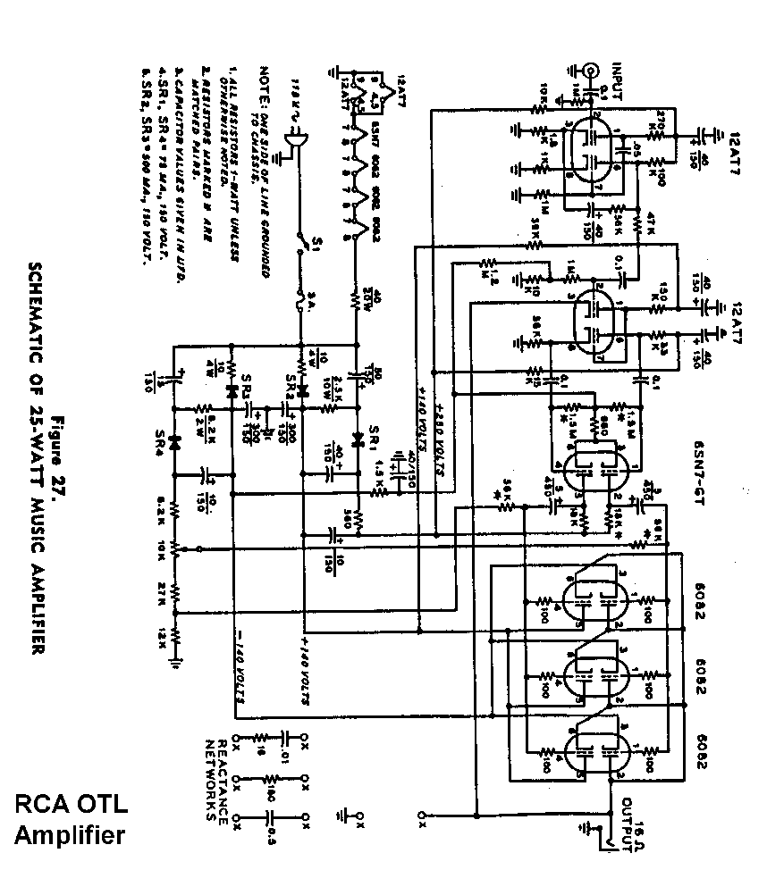

No problem Sy sorry about that was not thinking. The schematic in the article is not under copyright so I should be able to post solely that correct? It is from a public schematic for years now as its origin. Thx

I have been listening to the amp now for 3 days an it is as close to my rebuilt NYAL OTL3's in sound as any other otl I have built has come to sounding as nice. Great stage solid bass. Mellow sound but clean. I am currently using 5 NOS NIB GE 6AS7GA and they do sound better then my NOS NIB GE 6080's but not by much. You want a nice DIY OTL I suggest you build this amp.

BTW, there are 5 (yeah, FIVE) caps in the signal path of this amp, one of them a large electrolytic. I'm not trying to insult Mr. Orr, he's obviously a talented individual, but really all he did was cascade several stages and couple them with caps. Tim Mellow's design looks a lot more elegant, although I have no experience with either amp.
Well as you know I have built both.
I would agree that on paper the Tim Mellow's amp is more elegant but I have to say the Orr amp is sweeter in sound and is much more even in the curve of HZ distribution over the entire spectrum to my ears. But again yes the Mellow's amp certainly does many things very nicely.
