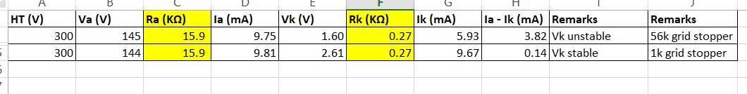

Hi everyone, sorry for my late reply and thank you all for your generous help. I think I figured out the problem.
1. The input was connected to ground, so the grid leak resistor was bypassed. I replaced the 680k with 100k, it didn't help (as expected)
2. I also played with different values of the grid stopper (56k in the schematic): 100k, 1.8k and 1k.
Interestingly changing it 100k or 1.8k did not help, however, when I changed it to 1k, everything works as expected.
I'd like to share my findings with you guys.
First of all, compared with previous 15.9k grid stopper, now the 1k grid stopper behaves in a much stable manner. In addition, there was a 3.82mA difference between Ia and Ik, now the difference dropped to 0.14mA (which could be measuring error or tolerance).
Then I further checked what was happening. I measure Pin 1 (grid), which is connected to the ground through the grid stopper. Grid leak is bypassed as the input is grounded, so theoretically the potential should be 0V. However I had the following findings with different grid stoppers:
100k: Pin 1 -1.4V
1.8k: Pin 1 -0.021V
1k: Pin 1 0V
I can't believe my eyes when 100k of grid stopper is used Pin 1 became so negative that it may draw electrons from the ground to the anode. This might explain why Ia (actually this is the sum of anode current and screen current) is larger than Ik.
I hope my findings would help in the future. And once again, thanks everyone for your input. Really appreciate that.
