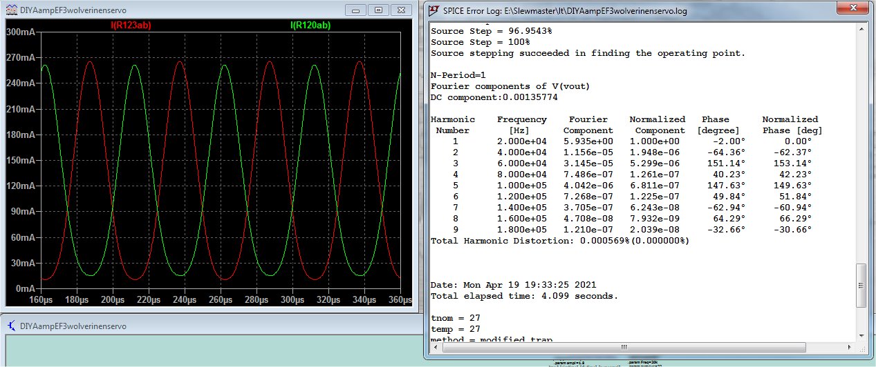

500 - 1000$??? For 1/5th of that , Son of badger is a steal - 180W of some
of the best "golden fan club" designs of the 20'th century can be
implimented easily. Base design "blameless" with the modular IPS option.
Some IPS's can have over 20W "first watt" before transitioning to AB.
EDIT - class A transition near 5PPM >10K .6-.8PPM (below). The only Pass amps
that can do this ... you buy for 10-20K$. PS - I like Pass's designs for their introductory
nature. While some are more complicated , simplicity is my main rule .
OS

... class A transition near 5PPM >10K .6-.8PPM (below). The only Pass amps that can do this ...
FirstWatt amplifiers is about exploration on 8 - 25W of 1 or 2 stage amplification, intended for the less popular higher efficiency, horn and FR speakers, a different objective from Pass Labs products.
In ppage 5 of FirstWatt F8 manual NP mentioned :
Nelson Pass
You will have noticed, I enjoy amplifiers with a little personality. They don't have to measure perfectly, they just have to sound good.

@ostripper: Quoting those numbers is misplaced. Pass does not design for THD numbers per se. The designs there target minimizing feedback while achieving a decent distortion level with particular distortion patterns which seem to be appealing to the ear (and the brain). In some designs more distortion is created to follow in the steps of the illusion commonly created by the tube designs.
It is all subjective listening driven while some measurements are referenced only to put some numbers on what one is listening to (kind of like reading a label on a bottle while tasting wine; eventually the palate decides and not what is on the label 😉). The hobby becomes even more interesting when one starts designing speakers, equalizing them etc. The playfield is wide open. it is all entertainment after all. It starts with the sound engineer recording any number of ways, mixing tracks, EQing the recording to his/her hearing preferences on their audio playback setup, etc. etc. One then takes that material and continues to tweak it through their own setup (room, speakers, source, amp(s)) to suit their own preferences. Those are not constant either and may evolve over time with more personal experiences with e.g. controlled directivity speakers, multi-amped setups, EQ etc.).
