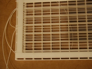

so is that 😉 The Hostaphan film I use starts to flow above ~4%.
So with just 2% I stay well away from this border. But as Zvon remarked right, You have to keep such things in mind.
I try to destress the joint spacer-film a bit by using soft materials (even when I use hard spacers I add some soft and damping material at those points) and up till today I had no diaphragm failure so far because of this reason. I have to admit that I have no 10 Years+ experience on this point, but all panels work for several years by now. A bit funny to me that the harder stretched panels all work easier, better and with less flaws than the softly tensioned panels 😕

I don´t recommend to stretch the film to the flow point! I stay well off of that point, stretching just ~2% where 4% is possible.
Acid etching might reduce the sharp edges problem a bit, but also reduces the thickness of the metal sheet and rises hole diameter!
I recommend using Polyurethane laquer too and not Polyethylene alone (it just has very high flashover values..all other parameters are less good). A topcoat of PU shows better electrical characteristics for overload conditions (lower surface resistance and higher epsilon).
PU laquer is easily available as a 2-component coating for boats and staircases, so its very rugged, it handles easily and gives very glossy and nice even surfaces.

I also wonder if Polyurethane has the same low required resistivity as Nylon66 or PVC, shall do some testing.

Bonding to mylar
The glue to use is Scotchgrip 4693 or 4693H which can be purchased in 5 oz. tube from McMaster-Carr for about $8. A 5 oz tube will be enough glue to make a pair of speakers, if you make a lot of mistakes along the way. If you don't, you'll have plenty left over.
This glue is formulated to bond to low surface energy plastics, such as polyester (mylar). It works. It bonds to the mylar so tightly that the film will tear before the glue lets go.

@silly:
You´re right, the basecoat should have a lower resistivity too. Idon´t recommend PE as insulator.
PU has -at least the infos I´ve got about it- quite similar parameters as PVC and Nylon (Nylon6) with regard to resistance values and epsilon and is easily available as laquer on the market.
