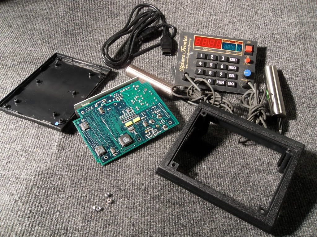

Hope you don't mind an interesting little diversion here... fascinated me anyway.

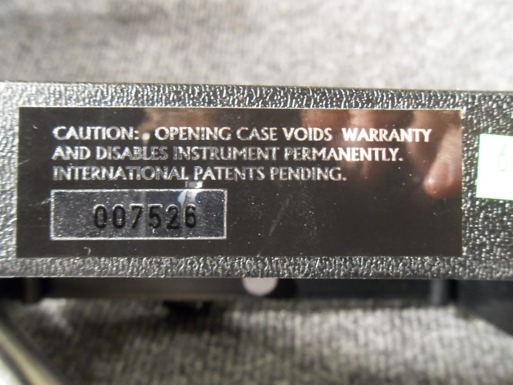

I was at a thrift store this morning and noticed this medical device for two bucks (half off certain items today!). It really pegged my bullcrap meter as I looked at it and thought it might be fun to actually look inside. Especially when I noted the sticker on the back warning "opening case voids warranty and disables instrument permanently". I just wanted to get a good laugh out of just how pathetic they dared to be when investing this "black box" with innards. It's some kind of electrotheraputic thingamabob with led readouts and handheld dongles. I suspected a board with a surplus ic and a couple of blinking leds. Or maybe empty space!
I looked it up when I got home and discovered that it was sold for anywhere from 1200 to 2000USD and landed the inventor/manufacturer in prison for pedalling a bogus medical device. He made 8 million dollars on them. What fun! I couldn't wait to look inside.
Man Sentenced For Selling Illegal Medical Device - San Diego News Story - KGTV San Diego

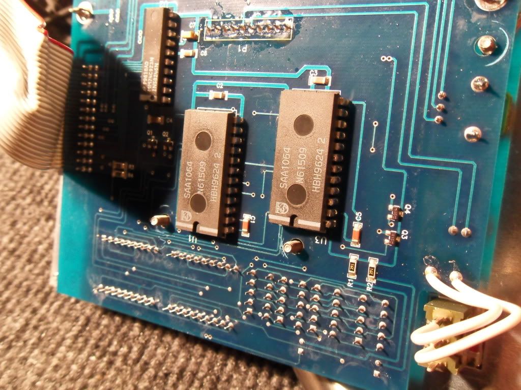

So I open it up and am a little taken aback by what appears to me, in my limited assesment, to be at least someone's concept of a working electronic device. What kind of madness actually compels someone to develop this into a 'functional' machine?

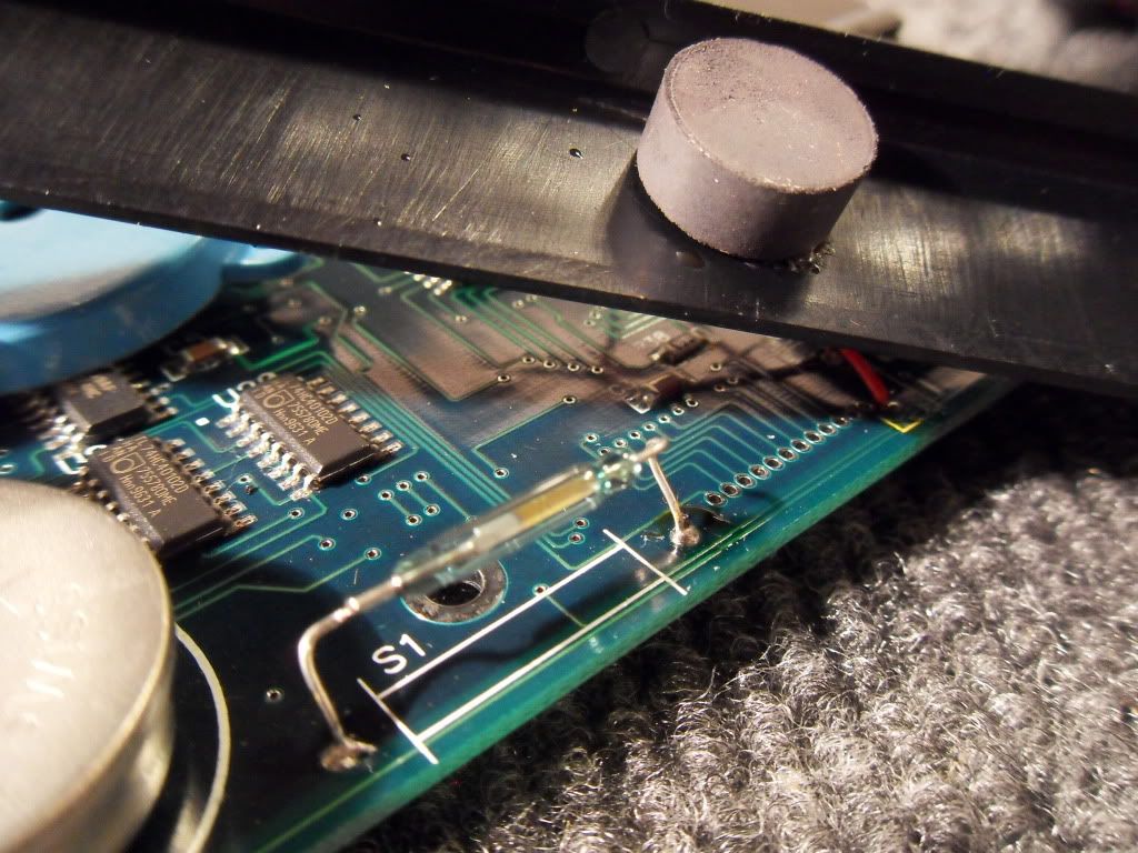

Weirder yet, in one of the photos I've provided, there appears to be a magnet affixed to the upper case/shell that ends up right next to a tiny reed switch on the board of the lower half. Almost like there really is some sort of self-destruct mechanism onboard when the cases are separated. Wow. Creepy indeed? 😛
Can anyone comment, just from a casual glance at the boards, on just how seriously the 'inventor' was taking this thing? Does it appear to you that he believed in his enterprise? Or is this just a board from some surplus junk repurposed to look semi-legitimate?

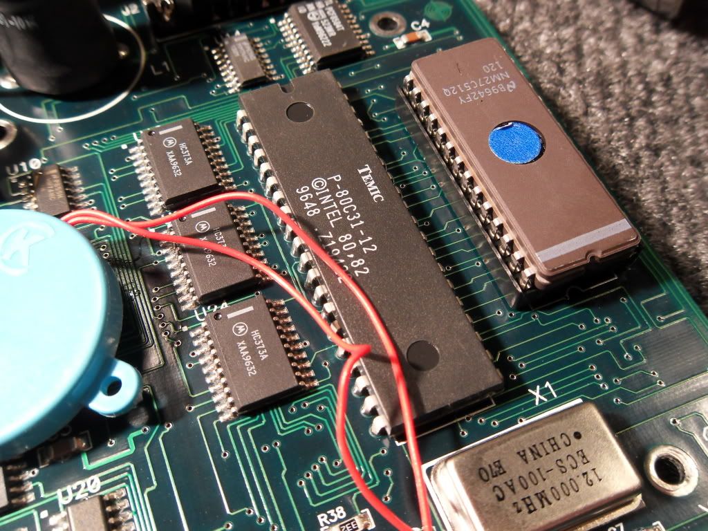

Are all of those ICs common chips, or are there any ASICs on the board? A couple of my friends and I have been working on IC reverse engineering - basically cracking the chips open through various methods and then slowly exposing each layer of the die and photographing it under a microscope. There is then image processing software that can use the shapes of common components (I forget what it is called, I do the hardware part of all of this) to produce the equivalent function of the chip from its images. I'd love to see what exactly the thing did originally - anyone know where one of those might be obtained? I'll take a look on ebay later when I'm not on my neighbor's insanely slow wireless.
The device has buttons and a display- so there are a bunch of controllers to take in the numbers and show them on the display. Any other stuff in there? (I wouldn't know myself).
At least one EPROM.

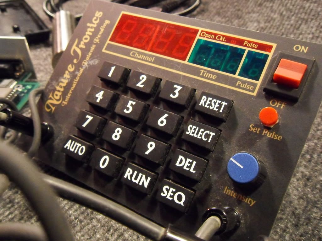

Is there any hint of what it's intended to do?

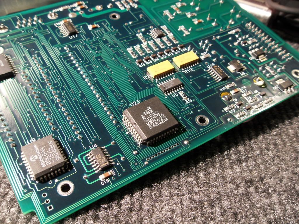

Someone has spent a LOT of time designing and laying out the pcb, so I can't imagine it's an effort to rip peopl eoff.
the designer at least must have considered it did something very useful and valuable.

I would definitely love to see what is on that EPROM. The two Philips chips in the 7th picture are LED drivers and the big Intel DIP is an 8 bit microcontroller. I'm still looking into the other ones, particularly that Qualcomm one on the bottom (but if it does have anything to do with RF I'm guessing that is the chip to handle that stuff). The reed switch looks to be wired to the power supply area and the EPROM, so maybe opening the case wiped its contents.
If I plan to sell something for $1500-2000, I think I wouldn;t mind putting some time into the design, even if it does nothing more than blink and put up numbers. If you plan to con someone, the whole point is to make the con believable.

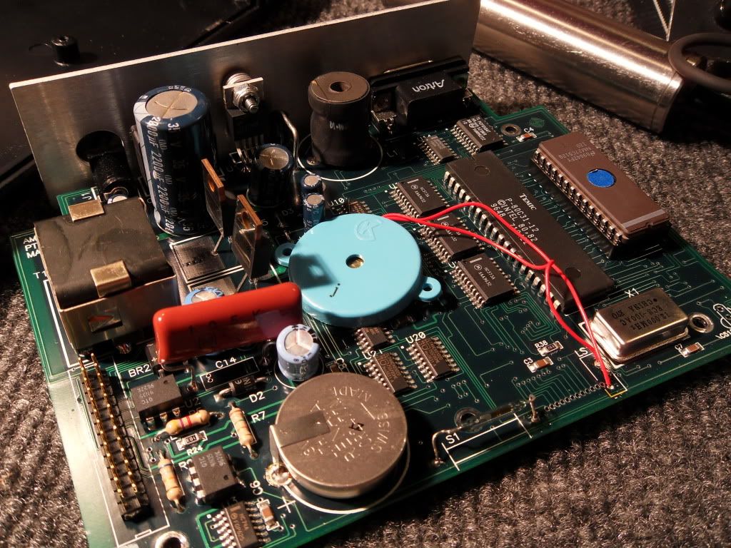

Looking at the reed switch, right next to a battery, I'd be betting that the reed switch when the magnet is removed either breaks the battery connection, thus causing any memory in RAM to forget, or possibly it shorts across the battery voltage at some point with the same effect. Load a program into RAM and send it out, anyone opens it, it forgets its programming.

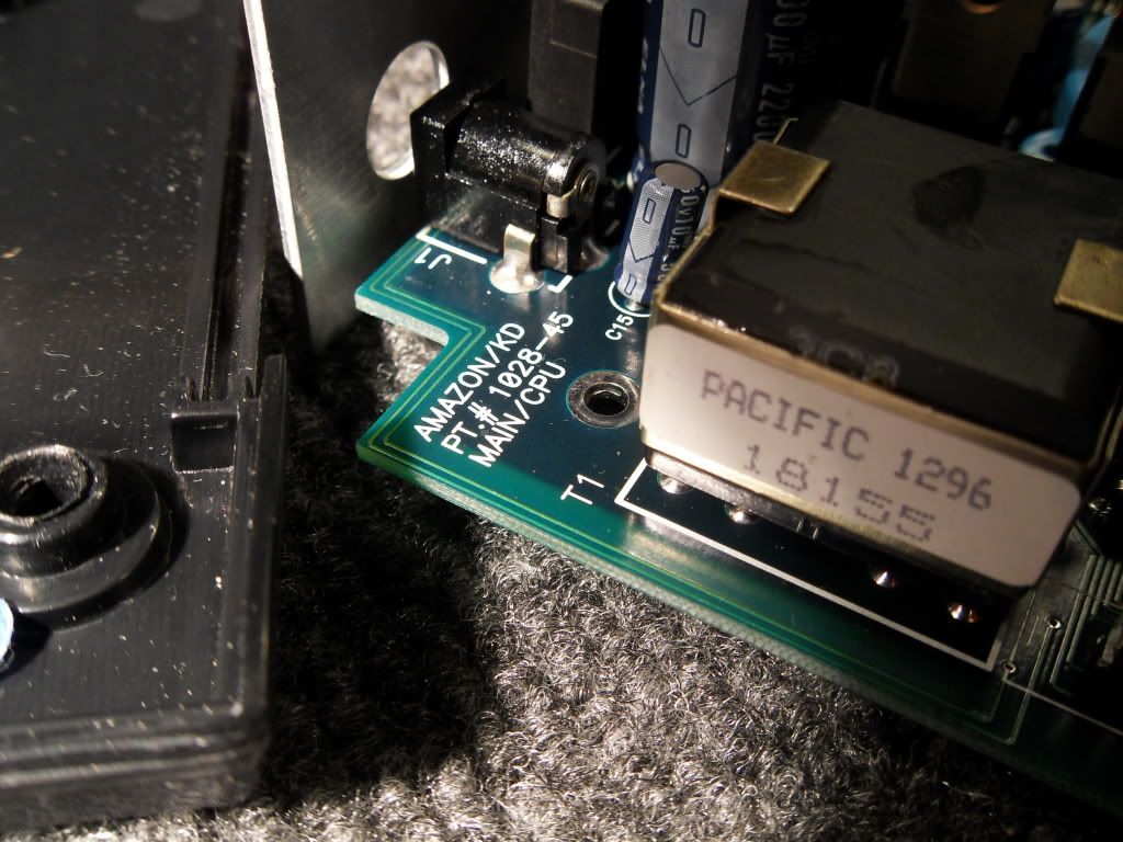

That Amazon/KD board number is probably a clue as to what the thing really might be. Or it could be a red herring.

I see the Qualcom chip and the Microchip 28C64A (I'm guessing an OTP EPROM), but this device could well have been made for some other function, with the front panel and buttons screened with the text for this quack-device and maybe even new code written for the quartz-window EPROM, and the other devices doing absolutely nothing in this implementation. These could have been a large quantity of an obsoleted device sold as surplus, and then repurposed by this shyster. I really wouldn't give him too much credit for many reasons, one being you wouldn't have to design such a thing from scratch.

Is there some large capacitor wired to the reed switch that might hold a charge after power is removed? Does removing the magnet cause the reed switch to close, or to open up? Worst case these extra parts are a couple of dollars, and for a several hundred dollar device, they could even do absolutely nothing to the circuit, but make the user think he's screwed up the device by opening it up. Even so, it would be easy enough for it to blow out a signal diode, which a logic I/O pin or two then find it to be open or shorted rather than normally operating, prompting the program to display an error code (or set one display digit to full brightness, giving the impression the multiplexing code isn't running) rather than running the main program. It doesn't have to actually destroy the EPROM, just make the user think it's been destroyed.I would definitely love to see what is on that EPROM. The two Philips chips in the 7th picture are LED drivers and the big Intel DIP is an 8 bit microcontroller. I'm still looking into the other ones, particularly that Qualcomm one on the bottom (but if it does have anything to do with RF I'm guessing that is the chip to handle that stuff). The reed switch looks to be wired to the power supply area and the EPROM, so maybe opening the case wiped its contents.
Probably like many others here, I've done my share of embedded programming, and have plenty of devious ideas of the things this could do and how it could do them.

There's continuity across the reed switch. Brought the little magnet up to it. I can break it reliably from about 1cm. Right there where it ought to be. Good lord why? One guy is in jail for this stuff. You can still find units like it on the net. Did the designers anticipate that and try to give themselves an out... a red herring for the prosecution?
"your honor, it's theraputic efficacy cannot be adequately apprehended. It's wiped out. Overwritten. Mistrial!"
Would there be any point in implementing a dodge like this for the sake of protecting intellectual property (i'm giving the designer that benefit of doubt again just for curiosity's sake)? Anyone ever seen this type of defense on anything legit?
