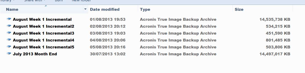

Acronis (back up program) is the single most important program I own. I make daily incrementals with a new sequence started each week, full monthly images are archived, and I backup docs/pics/music to flash drive as well.
I have a clean install image which is just Windows7 and updates (and nothing else) which makes for an easy fast clean install when you need it. Cookie files are saved so its a seconds job to reinstate all passwords/login data/site preferences after running a full browser clean.
Oh yes... never (and I mean never 😀)) use registry cleaners and "optimiser" programs.

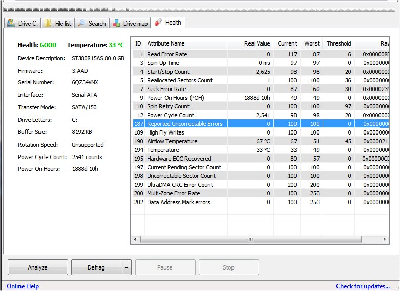

Good point, but what do you do when your HDD fails?
2 types of HDD "fail".
1- "click of death" (sudden)= controller failure. Find a similar model , replace the controller board. You might get the remaining MTBF hours out of the unit.
2-Un-correctable sector/errors , will "trip" S.M.A.R.T. (below - my oldest HDD ,1888 days). Best to remove any data you can , as failure of (more) magnetic data will soon follow.
(professional recovery can be the last resort).
Seagate is the BEST ! Many failures of Samsung/hitachi. SOME WD Hdd's can last 70-100K hours , others not so long (depends on model).
I had a 7 year old Intel dual core motherboard die recently. All the HDD's survived .So did the processor, video card and memory. The 12V supply failed in the main PC power supply - the capacitor leaked. This allowed ripple to the 3 phase motherboard regulator , which made those caps leak as well.
The 5V and 12V auxiliary supplies are less likely to be stressed , so HDD's and other devices (CD/DVD) are less likely to fail. Newer PC's needing extra 12V supplies for power hungry processors will most likely have DUAL 12V supplies.
I keep my data redundant on my network (an E-waste PC w/ 2 200gig HDD's).
Also back up on DVD. Some (2 out of 500) of my 9 year old DVD's have failed , but I have a 5 year backup schedule.
Soon , the heck with magnetic for archived files ....
With a 5 minute Google search I can give you dozens of forum posts claiming the exact opposite. The simple truth is that unless you run a fairly big datacenter with thousands of drives, any 'from my experience manufacturer X makes reliable drives' is completely anecdotal and irrelevant.
