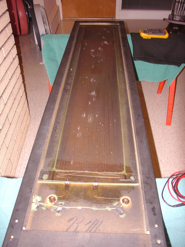

Anyone know of a retail source for aluminum winding (magnet) wire?
I need to make new coils for my Magnepan Tympani 1D's and the 1B bass panels.
23-22awg. I do not yet know what the tweeter wire ga. is.
I may convert to Cu wire but will need to calc. the differences in resistivity and mass so as to not disturb the panel tuning (natural panel freq.).

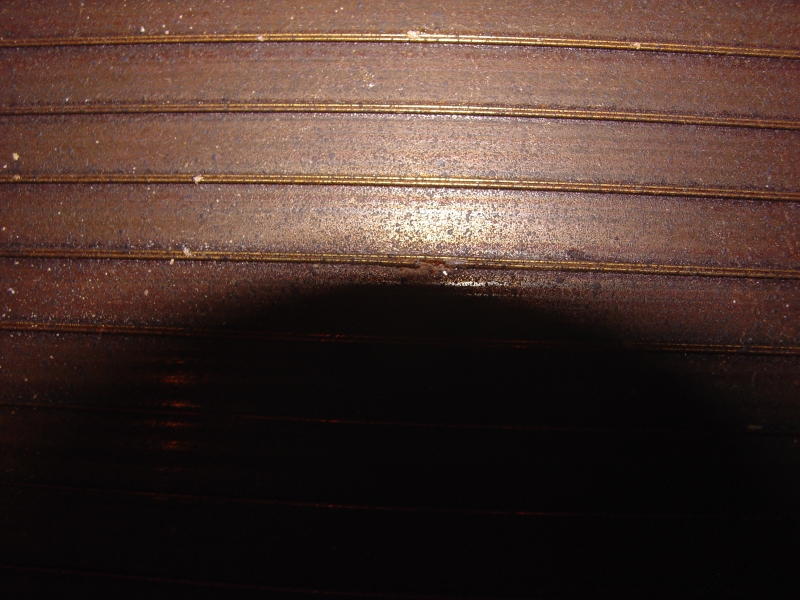

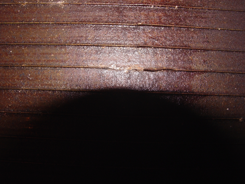

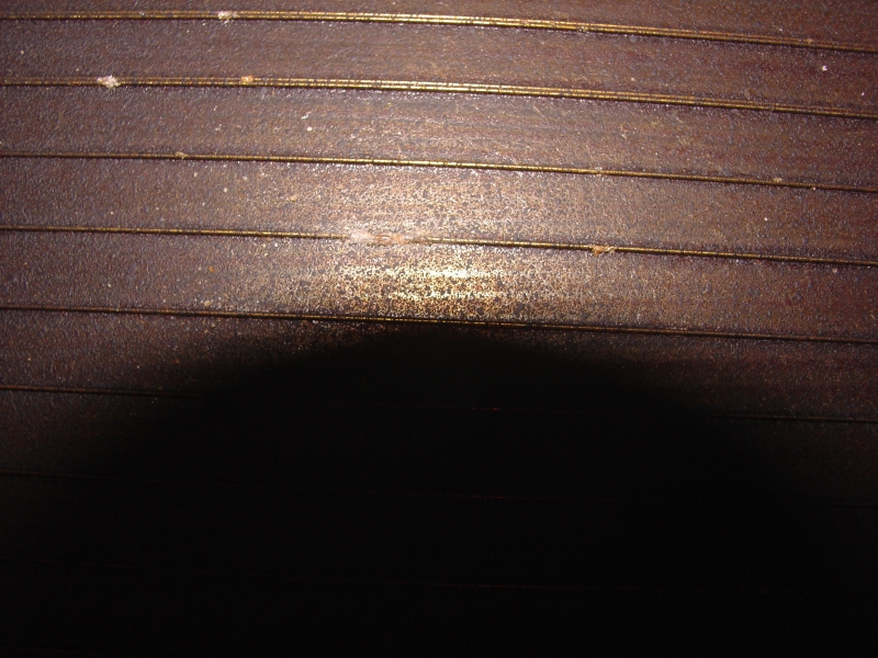

The need to replace the voice coils is due to the propensity of these wires to corrode. Almost a guaranteed requirement with these speakers (nothing to do with over driving, etc). If one has had them for more than 15 years... the odds are the coils will be corroded open.The "web" is full of folk who've experienced the need and some who've done the deed!

That isn't particularly good news, but it is believable. The original wire apparently corroded to death while the system sat unused..
Seems like replacing the voice coils on these things is going to be a huge amount of work.. I think Tympani1D must be a lot more patient than I am.. 😛
The end result with some care and good luck should be pretty good for the effort I hope.
I imagine Magnepan still repairs these, but I wonder at just how prohibitive a cost?

Having had to relay a mid panel of my IIIas last year, I observed that it was insulated - ie. it had a coating of some sort ... possibly merely anodising?
Anyhow, when cleaning the ends of the wires with sandpaper, in order to solder them to the solder-pads on the driver-frame, below the mylar (to connect them to the wires going off to the binding posts), the wire was a different colour when I had scraped off the coating ... and I was able to get a reading of the resistance of the loop, on my meter

I may be incorrect😱. It could be just aluminum oxide from exposure to the air.On my MG3as the wire had oxidized so badly in spots there were multiple breaks , all that was left was a powder at the break point .But like I said I may be FOS😀

I believe it is insulated, uncoated aluminum wire corrodes very quickly. The coating however is not continuous (due to defects) allowing air and other corrosive agents contact with the aluminum.. The aluminum itself may already be corroding when the coating is applied which may also contribute to the problem. The stuff oxidizes readily in air, and with stronger oxidizers is a major constituent of solid rocket fuel (right after the oxidizer) used in the Space Shuttle amongst other things. http://stason.org/TULARC/science-engineering/space/56-Solid-rocket-booster-fuel-composition.html
