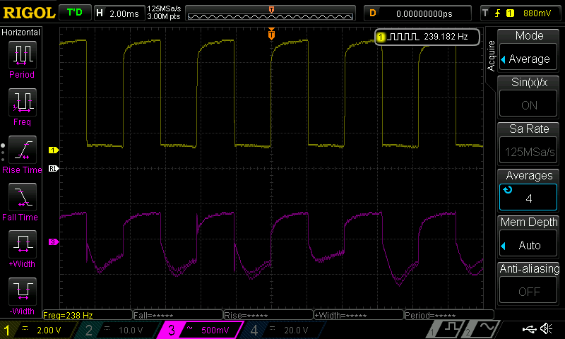

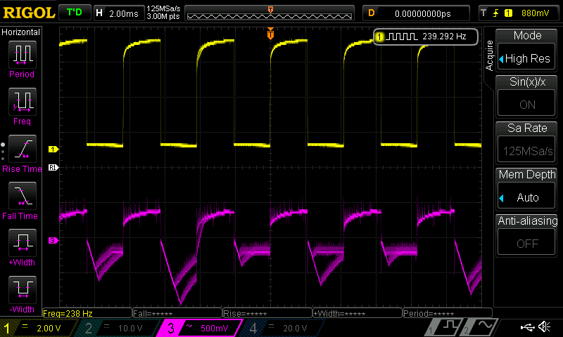

To continue the discussion on this topic, I made a few captures of a test setup that I thought might be useful for comparison.
The setup is a cheap swith mode wall wart powering a PWM-controlled LED-strip.
This shows a couple of things: the switching noise, the reaction to the pulsed load and a lower frequency superimposed.
CH1 shows the PWM-output to the LED-strip and is used for triggering, CH2 shows the output ripple and noise of the wall wart.
Fuzzy in other words. By averaging with few samples you give noise less weight as a normal analogue scope would. This noise isn't valid data once you consider how many adjacent data points you are missing. That is why I suggested 4 averages instead of 32 or more.
First attachment shows the result in normal acquisition mode, the second averaged to 4 and the third in high res mode. And for comparison what my Philips PM 3208 shows.

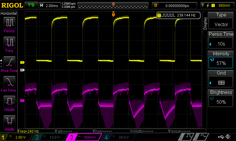

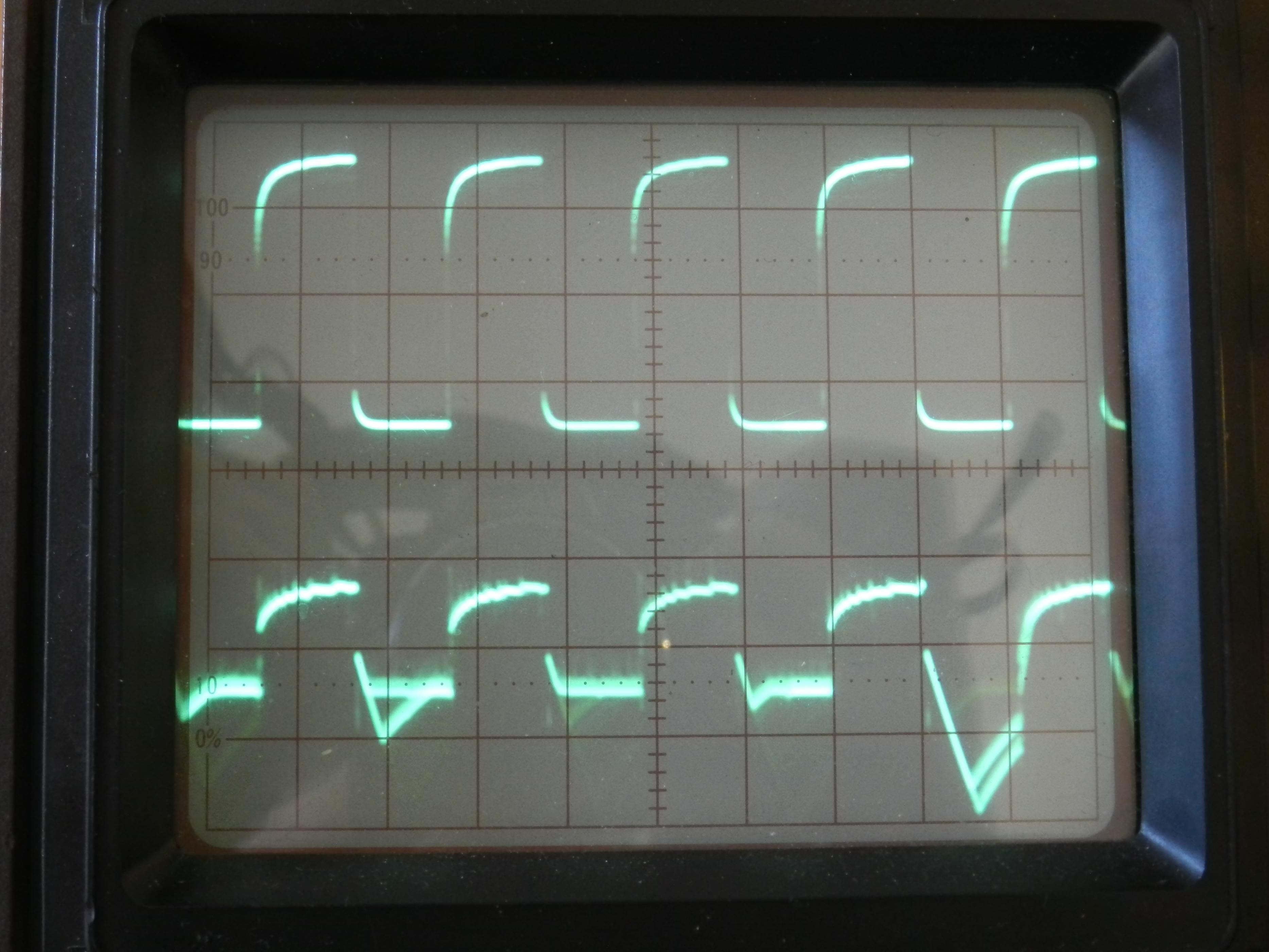

This wall wart doesn't like it if the duty cycle of the PWM controller is set somewhere halfway. The light is visibly unsteady. Use a better adapter, and this issue is gone.
The last attachment shows how unstable the wall wart is at these duty cycles with a persistence set to 10 s (the other captures were taken at min. persistence).

Yes, you can see how much more useful it is to average a low number of captures. This mode specifically will not show runt pulses of any other "one off" signals. But then, that is why you do averaging. This is closer to an analog display since our eyes do the averaging. This mode is great for showing waveform details that are consistent.
That is a great demonstration you picked. It's also a real world situation. Now you know more about the LED driver too!
I think your choice to show various averaging was excellent. It really shows how to use the features of your DSO to the best advantage. This little scope is even better than the last one I looked at - expected. Rigol is an excellent company. As for the trigger issue yours doesn't have, that was probably fixed in firmware or hardware. Another reason it doesn't pay to be on the "bleeding edge" with new product. The "feature patch" is an uncommon bonus - good for you! Mind, you probably killed the warranty. In all likelihood you won't need the coverage. Your variable persistence is something I wish my scope had. Its either on or off.

Your analogue scope shot shows an error when I try to expand it.

It's unfortunate that you weren't able to expand the photo of the analogue scope. Here's a link that should work. It shows that the litle pulses riding on top of the wall wart output are also picked up by the analogue scope. In this case I would say that the averaged trace on the DSO is looking cleaner than it really is. The high res mode seems to come closest to what the analogue scope would show.

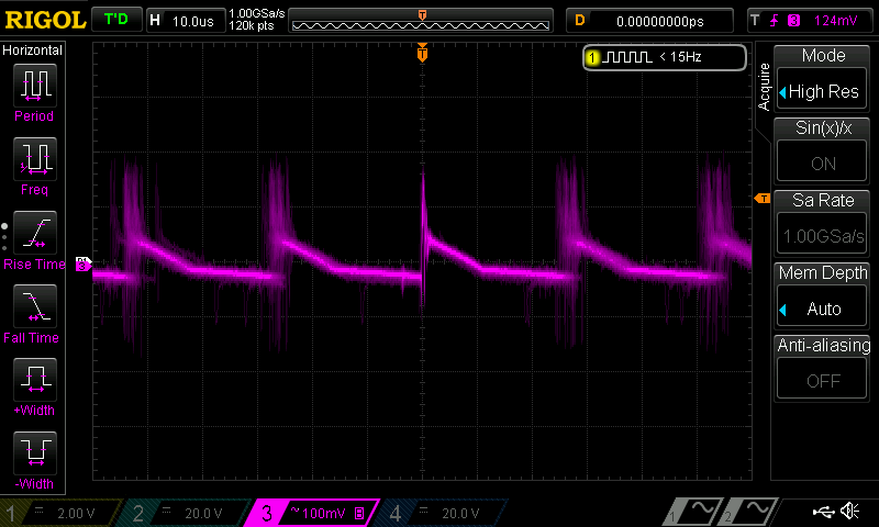

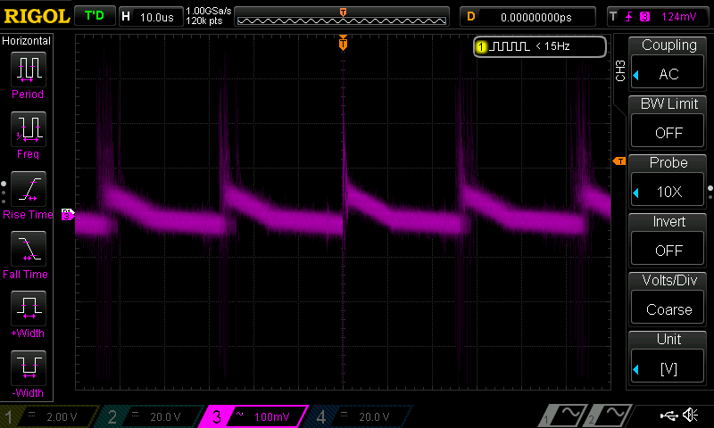

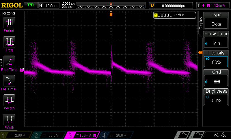

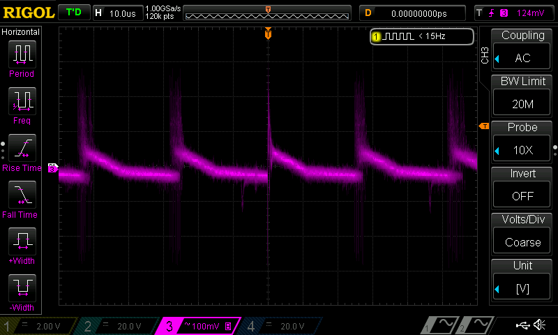

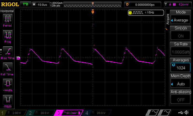

If I run the LED-strip at full output, there's only the noise from the switch mode wall wart. I tried a few more things on the DSO with acquisition and display settings.
First attachment is the noise in normal acq. mode, quite a fat trace, so I switched in the 20 MHz bandwidth limit which yielded the second attachment.
Third attachment shows the thinner trace in the high res setting.
The fourth attachment is with display in dot mode instead of vector mode. This really shows how jittery the switching noise of the wall wart is.
The last attachment is with a high number average to show how much that has an effect on the result. Quite a lot, but note the dots in the third division above the centre. Only based on the normal acq. mode would I have expected anything there. But that does explain why moving the trigger level way above the visible signal didn't result in losing the trigger. Perhaps I should have turned up trace intensity to see that.
Hmm, at home and at work I have no problems expanding them (both running Chrome), so I wouldn't know why it doesn't work for you and what I can do to avoid it in the future...

Chrome works it seems. Firefox is getting testy, or is it NoScript? Either way, nice shot. All the other pictures opened fine in Firefox - go figure.

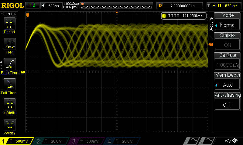

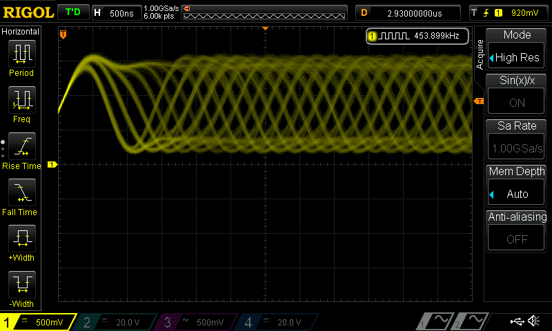

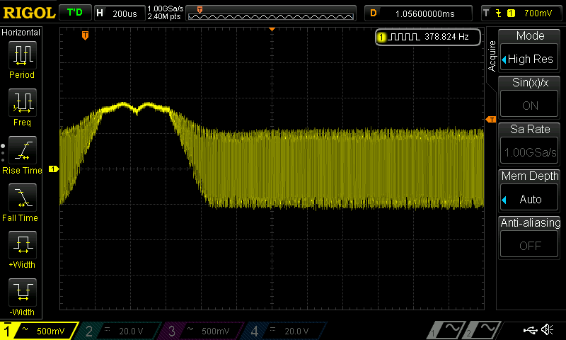

Good idea. I still have my Nakamichi CD-4 that I just brought down from the attic. It still works. The first attachment shows the eye pattern in normal acquisistion mode, the second in high res mode.
I also tried to trigger the HF-RF depression using a special test-CD, and it took some fiddling with the knobs, but it works.
What both look like on the Philips scope can be found in this post from 2008.

That is a wonderful scope you have there! Those eye patterns are Agilent quality. I would be happy using the scope you got for service. The envelope looks good too. Zero complaints from me!
There we go. Finally DSO quality at a price many of us can afford. I have to say that I am very happy for you jitter.
