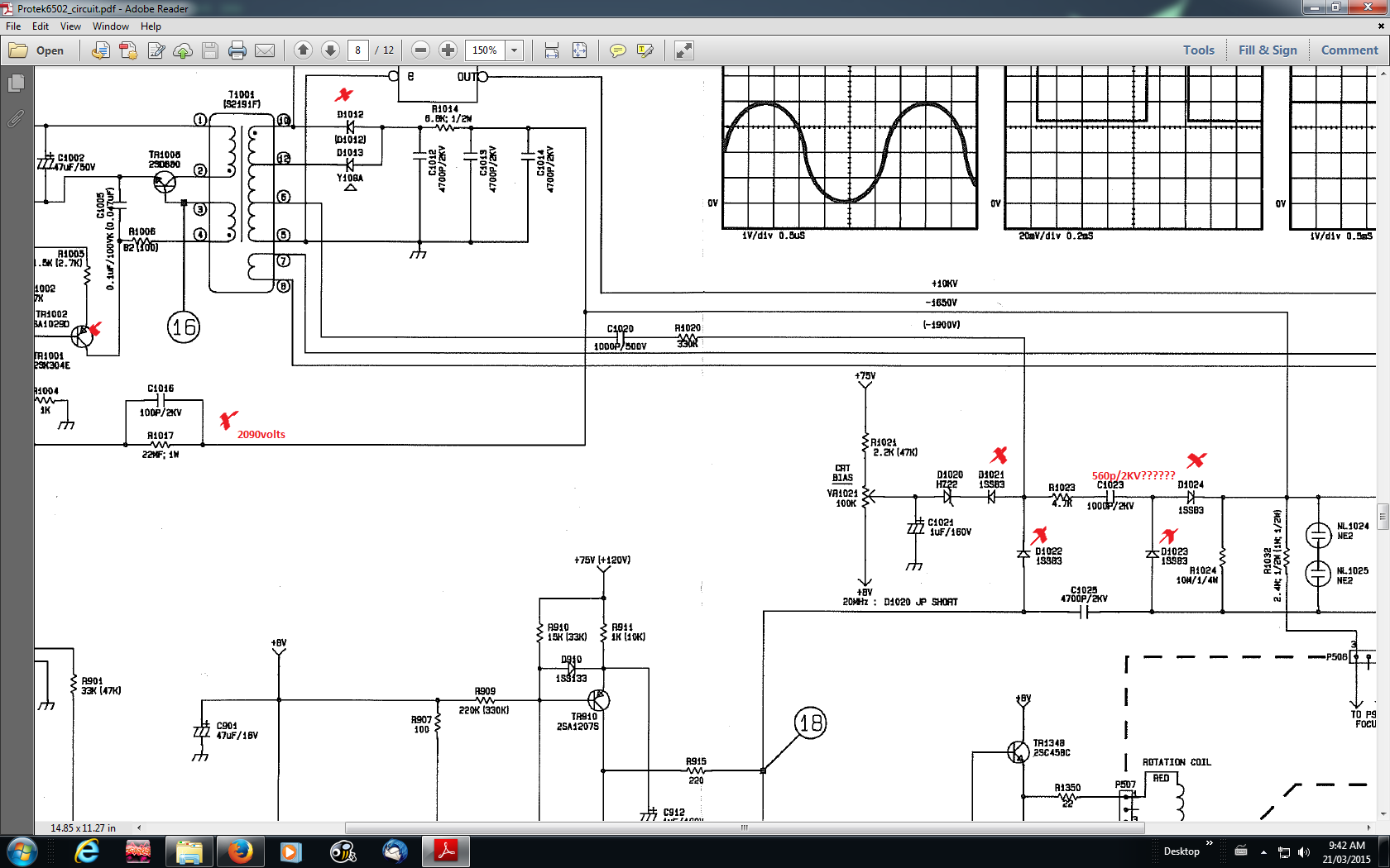

I just pulled PNP TR1002, tested it and it came up OK? Ive replaced C1002 as well,it read OK but I replaced it anyway.TR1005 is OK as well.When this sparking started it was across R1017 to start with and has since migrated to D1012,up to C1023 and back to D1012 next to the fly back transformer. What do you mean by pre=set? is that a resistor? If it is what sizes should I start with to do it manually?
Yes, a variable resistor. You could try anything in the 10k to 47k range.

I asked about the neons because they are an overvoltage clamp, so if not lit it suggests the EHT isn't excessive.
You need to investigate why the FET + PNP transistor is apparently having no effect on things. The PNP transistor should drastically alter the EHT as its conduction alters, and using the preset resistor across D-S of the FET would do that.
Lets just recap on this to be sure. FET in or FET out and there is no change ? FET shorted D-S no change ? If that is so then I think replacing that PNP is next on the list as well as checking all around that stage for breaks in continuity etc. At a basic level turning that PNP on and off has got to have a drastic effect.

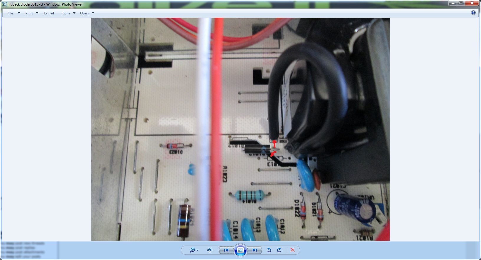

Ive been following the tracks trying to work out what is going on here when I realized the first 2sk340 datasheet I had downloaded had given me the wrong pin-out? That's why I was so confused,I know you said it was like for like but I didn't think that a datasheet could be wrong? So its soldered back in the right way and now its sparks in rapid succession at turn on,(like in-rush current)then settles down and doesn't spark again at all at the moment. The spark goes from D1012 cathode through the zig zag hole in the board to the soldered side and occasionally across to the black wire on the fly-back transformer.One neon light stays on for a while with a dull orange light and the other lights up only when it sparks? The screen still looks the same,the only difference is the trace appears at the top or bottom of the screen every time its turned on.Sorry about my mistake.
That all sound like excess voltage. The PCB cutout is in anticipation of that, the normal working voltage is getting to the point where it needs air spacing for reliability.
So we are back to excess EHT and seemingly no control over it. You need to try the resistors to turn on that PNP (replace it to) and see if that alters things.

The high voltage tester still hasnt arrived (lost in the post) so they are sending me another one? I ordered two FETs,they've arrived so I installed one but it made no difference it started sparking from D1012 like crazy. I desoldered one pin on all the resistors and diodes around the circuit to check them all properly and found ISS83 D1024, is out of speck it reads on DMM diode setting out of circuit,.410 forward and .980 backwards! So maybe that was bouncing the voltage back to D1012? Now I'm going to have to find an equivalent for ISS83? Do you think a IN4001 would be OK? PS Happy New Year!!
That diode is definitely faulty with readings like that. Its also high speed high voltage type. Something like a BA159 would be OK (same package as a 1N4001). The 4001 is only 50 volts but even the higher voltage versions such as 4004's are not fast enough. This part of the circuit is working with the fast rise time high frequency flyback transformer derived voltages.

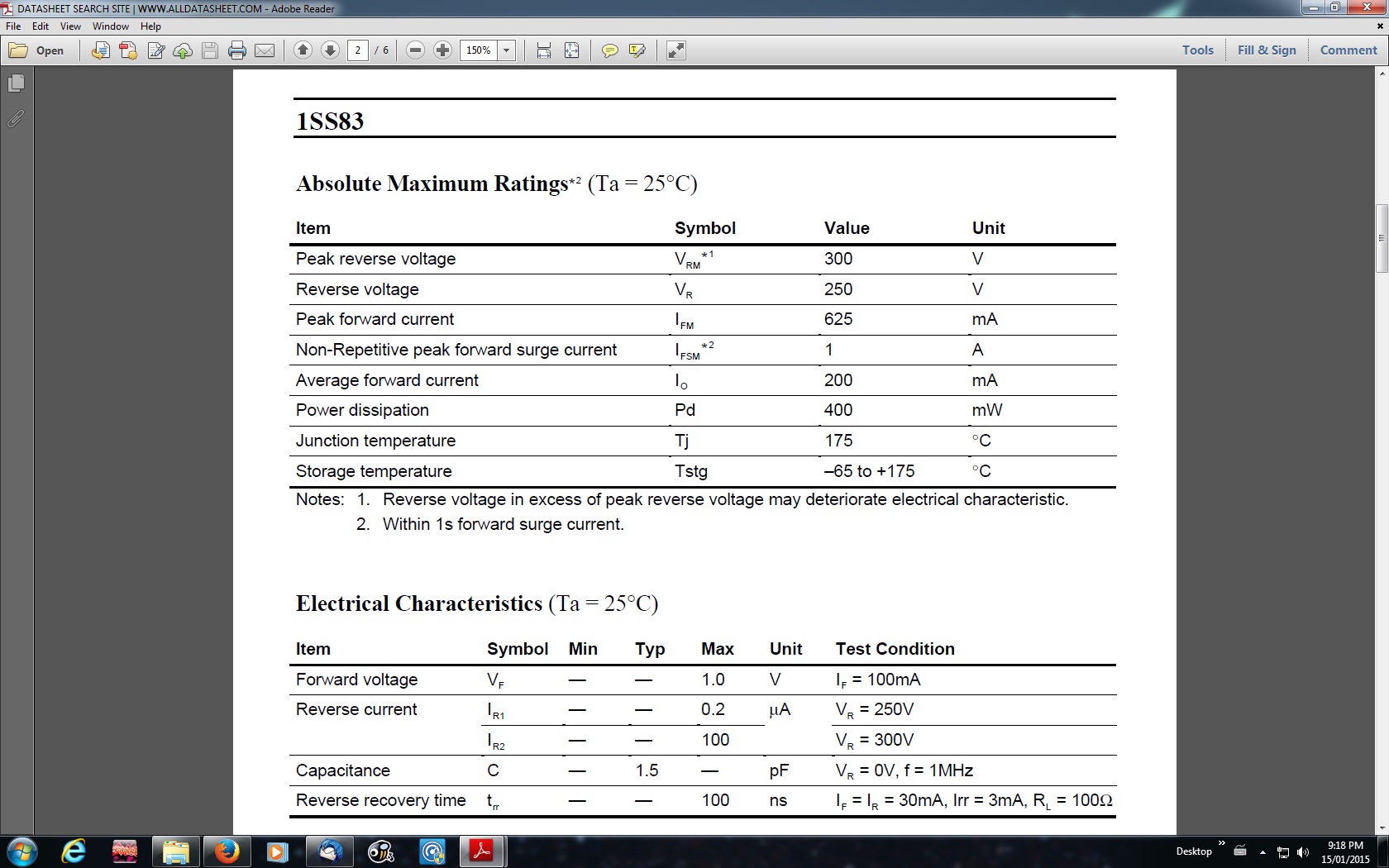

OK it looks like this is the problem then? Here is the datasheet for the ISS83 Diode.I can get UF4004, 400v,1a,ultrafast diode would that do the trick?
If the UF device is a fast diode then yes, it should fine. These high speed versions have appeared decades after the original devices came on the market, and I have never used them tbh.

The ISS83 diode is glass encapsulated,my oscilloscope is a Protek 6502 not Hitachi and I was talking about the UF4004 not the UF1007? The UF4004 has half the recovery time and the same capacitance.I hope that clears things up?

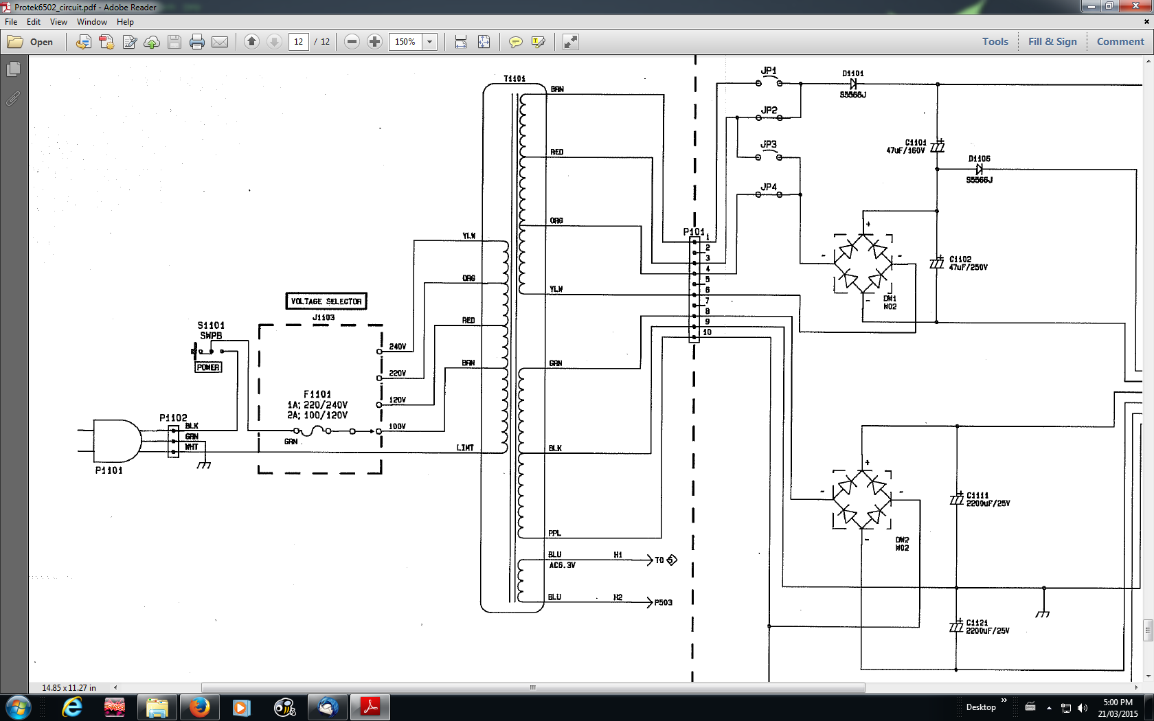

Are we 100% sure that the transformer voltage setting is correct. You mentioned it arrived with the selector damaged, the tranny gets really hot...

Yes I'm fairly sure its set on 230volts because the yellow line is 230volts and that's what its connected to yellow (230v) and brown (100v)? The brown wire is connected to the other side of the fuse and isn't adjustable? So what that's about I don't know?
That's clear enough I suppose although its worth measuring the 6.3 volts (AC) heater winding as confirmation. It should be pretty to close to that value (5% or so)
The only way I can safely measure any voltages is to power it on with a dim bulb tester and then Ill get a lower voltage reading than what it should be. I'm starting to suspect the mains EMI filter box is shorting against the case because its loose, it must've been connected to the power inlet module? The trouble is Ill have to nearly completely disassemble the whole scope to get at it.Whats the chances of that shorting?That's clear enough I suppose although its worth measuring the 6.3 volts (AC) heater winding as confirmation. It should be pretty to close to that value (5% or so)
