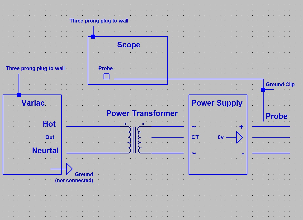

I finished a bi-polar power supply and would like to look at it on the scope. I've attached a diagram of the basic concept. I'm confused about the probe ground clip. Since I'm going through a transformer, the power transformer in this case, is it safe to clip the probe ground clip to the 0v ground, or CT, of the power supply. Is the power supply floating? It confuses me. Thanks

Yes its safe. Your transformer provides isolation. Note that if the 0v point marked on your outputs really is connected to mains earth (and it would be normal to do so in many cases) then the scope ground lead can only be connected to this 0v point. There's no safety issue there, just that it would put a short across the rails if you clipped the ground lead to either the pos or neg rail (which is in some cases a valid test mode depending on what you are looking at. If that 0v point is "grounded" then the supply is still termed as "isolated" because of the transformer but technically its not "fully floating".

I think the op will be getting confused with all this :)
Important points...make sure the scope is wired as per the manufacturers recommend with regard to its mains lead (that is, is correctly grounded).
Realise that the ground clip of the scope probe is connected directly to mains earth.
So following on from that, if you are working on a low voltage power supply such as in post #1, appreciate that if the 0v line is connected to mains ground, then your scope lead has the ability to short out anything that is not this 0v point. For example, touching the scope ground clip on the pos rail will make a big bang... but there is no safety or shock hazard.

As a rule, do you usually connect the variac output ground to the power supply ground when testing or just leave it hanging?(safely).
The variac should be grounded if it has a mains safety ground.
Whether you connect the mains ground to your power supply 0v line is up to you. There is no safety consideration in either case.
In audio, connecting the 0v line to ground may cause a ground loop but that depends on what else you connect to your audio circuitry.
