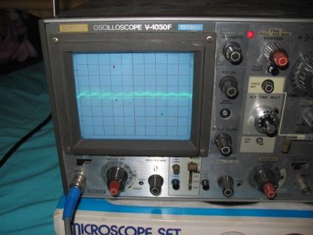

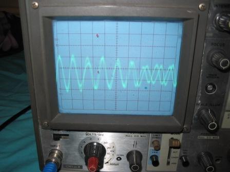

Here's some pics - not very good I'm afraid - showing clearest trace I could get on the scope. They are for:
- amp with no load and 10,00uF cap between PS board & Output Board
- amp with no load and no cap connected
Don't know if you can see all the squiggles? but there are more on the second photo. What is the significance? I presume a clean, low impedance PS would be a straight line? Camera ran out of battery before I could connect up 12V 7ah battery to power outputs stage!
Second pic - no load no 10,00uF cap
As you can see I can't get a full scale trace on the scope clearly - it seems to go out of focus but focus knob doesn't sharpen it!
Am I doing things correctly?
