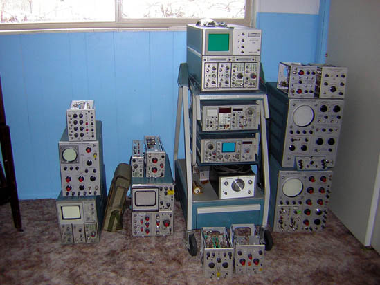

😀 There is only one answer to this question for a general purpose scope. :att'n: Good used Tektronix 465B 100 mhz scope. Don'rt buy anything less than 100 mhz!!! I got mine for 75 bucks on E-Bay.
ALSO!
Don't buy a Digital Scope unless you can get a top of the line model(new or used). The inexpensive Digital Scope Meters cannot properly display all types of waveforms due to slow refresh rates of the display.
Bandwidth more than 20 mhz may be needed to check an oscillation in an amp/preamp!
Mark
Photo:
My Scope collection missing the TEK 465B and 7603 that are at work.
