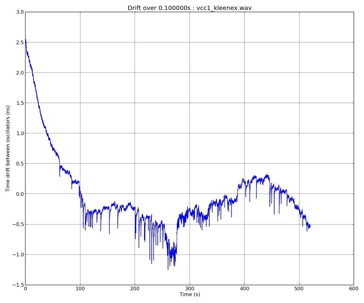

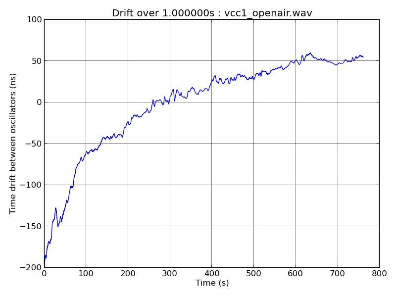

OK, here's how I built a phase noise rig for about $2 (including the cost of the oscillators being tested, which were $1 each).
Get two XO cans of same frequency.
Grab some AA batteries from battery bin for low noise supply (2AAs for each clock, 2 for mixer)
Grab 74AC00 from junk bin, this will be our mixer
Add some power supply caps from junk bin
The mixer output gives us a beat tone which is the difference in frequency between our clocks. Lowpass that and acquire with soundcard for 10 minutes.
This beat tone will be between a few Hz and a few hundred Hz. More Hz works better, so put some new or used AA batteries on one of the clocks to adjust its frequency slightly, to get a beat tone above 50 Hz.
Next comes a little bit of easy DSP in software on the PC. The nice thing is that the soundcard clock phase noise is rejected from the measurement. So we get a measurement of the difference of the "internal time" of our two clocks. It's the same as talking about phase.
Attached plots are how much those two clocks drift relative to each other during 1s. One of the graphs has a wad of kleenex put over the clocks, which makes them drift a lot less as expected.
Once you get the time delta between clocks is is easy to rebuild (in software) the mixer output that a real phase noise rig would generate, using a perfect VCO. I'm not showing plots cause my $1 clocks aren't very interesting... ok, the measured phase noise corresponds to what the datasheet says, but I'd like to check the system with better clocks to see if it really works first.
You only need a fancy VCO (which is the major cause of headache) if you want to measure an arbitrary clock, and if your measurement setup is only able to measure DC.... by acquiring the beat tone, as long as it is within the soundcard bandwidth, no problem. So this system needs two clocks of identical frequency, but the more difference between them, the better, as long as it is in the soundcard bandwidth...
Now, I need to figure out a way to generate a I/Q beat tone instead of a plain tone, to get much more precision. And maybe use autocorrelation, that would need 3 clocks...
