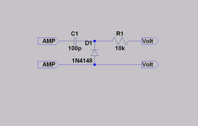

Assemble this very simple test probe, connect to amp output and voltmeter as shown.
Any significant voltage without signal means high frequency oscillations...

ok, well I tested with and without the sound card output connected...
without the soundcard connected 0V DC recorded
with the sound card connected but no signal, with volume at mininum 0V DC
with the sound card connected and volume cranked to maximum 1.9V dc recorded.
I assume that 1.9V is a significant voltage :)
I'm guessing I'm picking up something in the preamp section which is making it through to the power amp.....
Tony.
