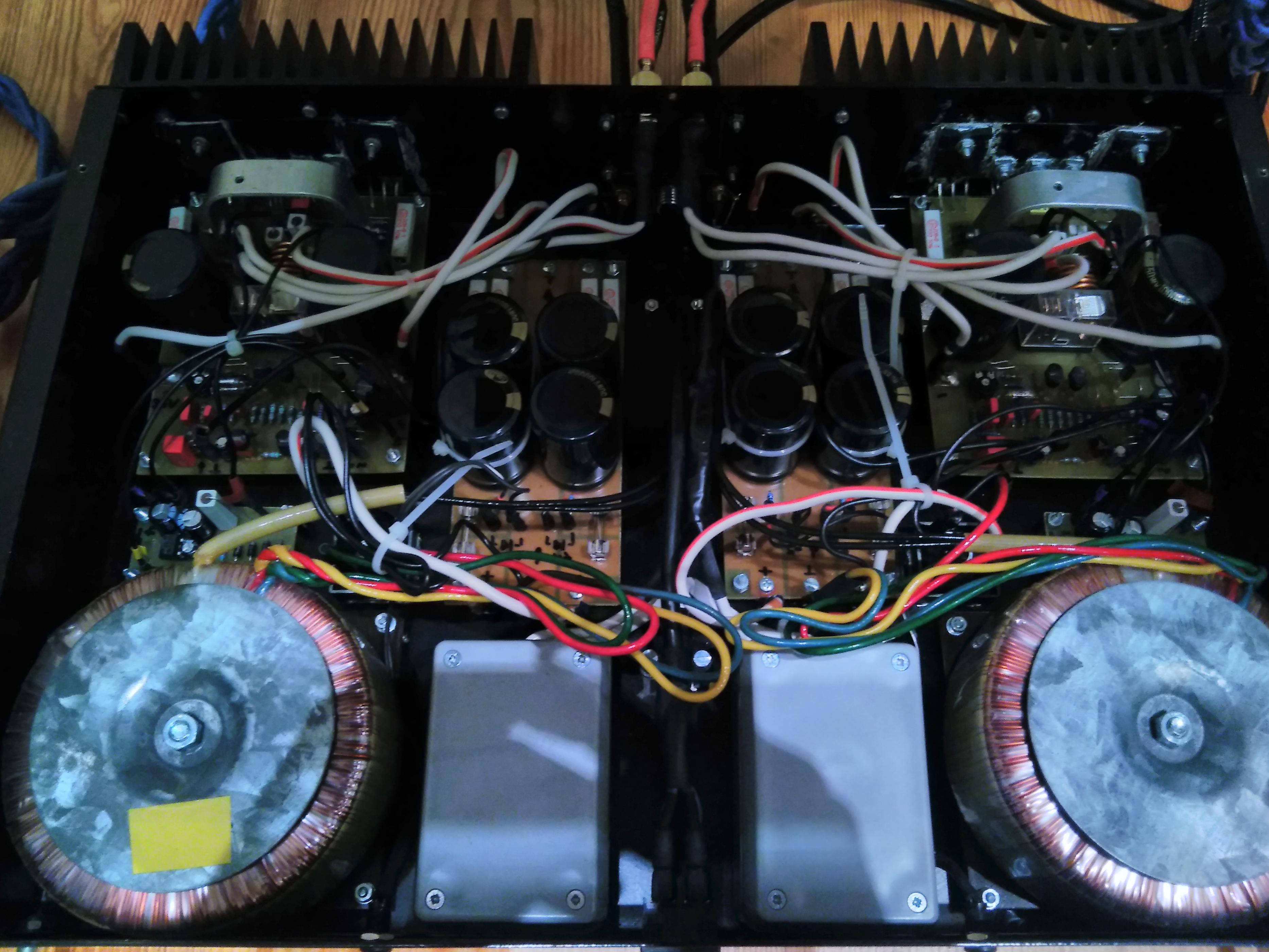

Chesus...I have one of these amps.
Quite nicely built by someone.
Dual mono, soft start, lots of caps (unfortunately Samwha)
My problem is that if I adjust BIAS to 100mA it will swing between like 50 and 150mA at a frequency of 0.1Hz or so.
Also every now and then one channel will go into protect (relay just opens)
Is the DC offset adjustment done really weirdly?
I am no expert in this particular matter, but connecting rails straight to the 1M offset trimmer, is that a good idea?
If I touch any ground, output, rail or emitter resistor with my multimeter I immediately hear a faint pop and relay opens. This can happen to both channels, but one is much more sensitive.
When I got the amp it was ungrounded. But I added a grounded mains cable and now everything is tied to the same ground (usually not a good idea, but here it works as before. Without hum.
Amp sounds awesome though...but yes it is a pain in the sitting organ.
Someone buy it from me, please! 🙂
