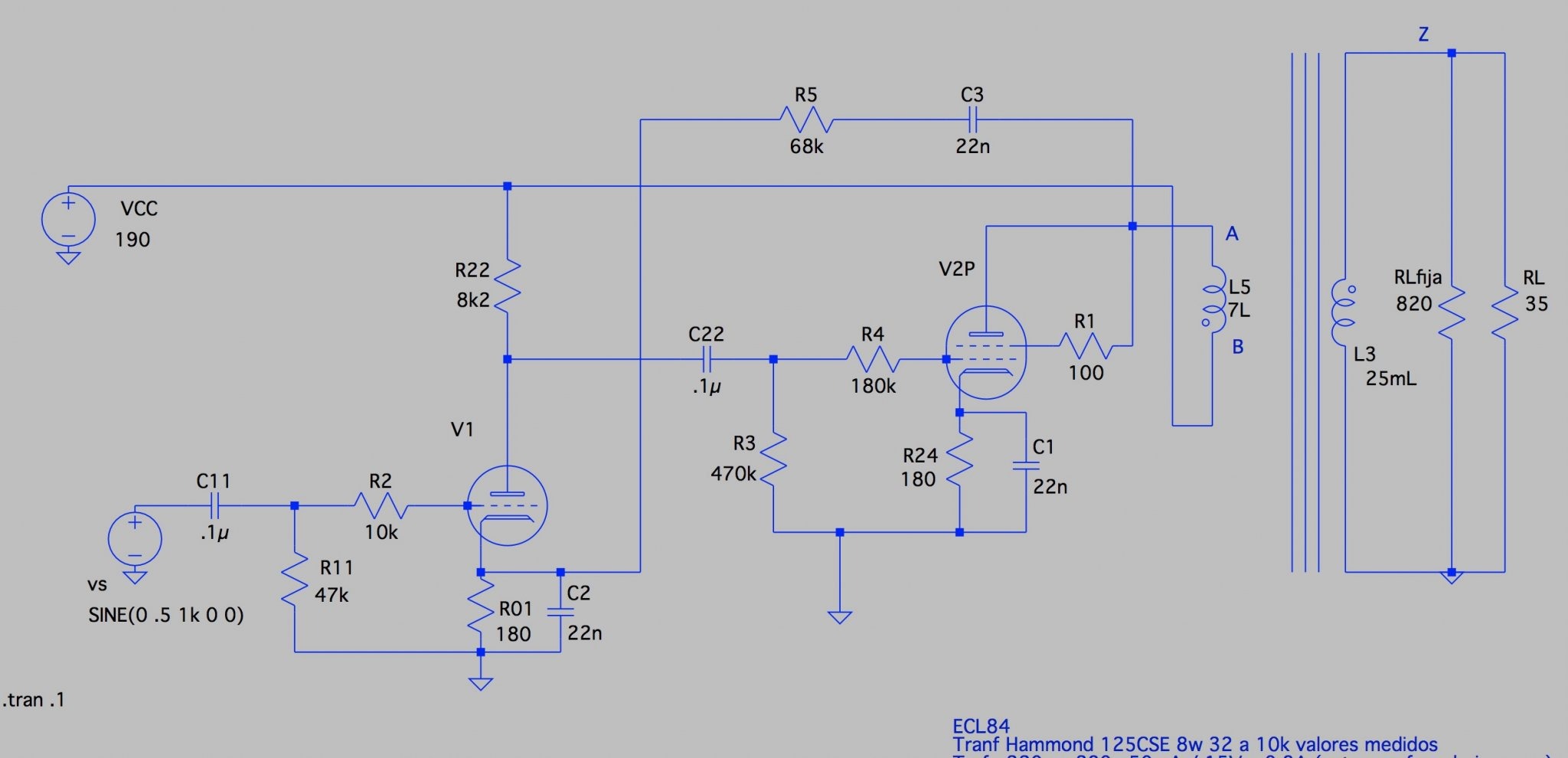

In an amp where I used ECL84 tubes, I had to increase the grid stopper resistor from 10k to 180k to solve an awfull oscilation in the pentode.
Such a high value means something is wrong that should be solved without such a resistor.grid stopper resistor from 10k to 180k to solve an awfull oscilation in the pentode.
Post the schematic, with photos of the grid and anode ciruit wiring, and (if possible) the frequency of oscillation.
G2 stopper or G1 stopper? With or without global feedback?

Hello Rod and thank you for the interest.
The oscillation was at 140khz at the pentode part of the ECL84.
I didn't try with something in between 10k and 180k because it solved the problem, but maybe 47k also will do it.
The circuit is in a PCB, so no wiring except for the heater that was wired to the PS.

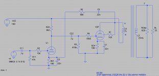

You just made that your dominant pole. With only one stage ahead of your final, this may be practical. Dominant-pole compensation usually puts it it the first stage, and then tries to shove the milller pole in the output stage (or two stages) up as high as possible. Then you would minimize the stopper resistor. 22 nF cathode bypass caps look a little unusual, putting poles in the degeneration at around 40 kHz. At first glance without other calculations I can’t say whether that hurts or helps.
140kHz oscillation means it is not self-oscillation - so a stopper is not the soluton. 140kHz means a loop oscillation, and the problem looks like the feedback is returned to a node of the wrong phase. You can apply feedback to the grid of the same valve, or the anode of the driver (but not the cathode of the driver).
change the G1 resistor to a much lower value, when you have corrected it.
That's classic feedback over two stages, like phono equalizers used to be done, but C2 doesn't belong there and C3 should be designed out. (It'll promote subsonic instability.)

Oh, oh, shame on me, I got confused with the phases. 😵140kHz oscillation means it is not self-oscillation - so a stopper is not the soluton. 140kHz means a loop oscillation, and the problem looks like the feedback is returned to a node of the wrong phase. You can apply feedback to the grid of the same valve, or the anode of the driver (but not the cathode of the driver).
or mabe not, Rk (that are needed to bias the tube) are a negative feedback, that's why they are bypassed by capacitors in order to gain more. The feedback loop is in phase with Rk voltage, increasing the negative feedback.Oh, oh, shame on me, I got confused with the phases. 😵
Your feedback is of the correct polarity to be negative feedback. Phase is a different thing and the two shouldn't be conflated. However, C2 is a mistake, and C3 should be designed out. (To keep the first stage valve properly biased, the resistors will need to be adjusted.)

Well guys, the amp is running in both the SPICE model and in the real world with the values published.
Now I am solving some hum and buzz (probably from the PS), and then I will try to improve it.
Anyway thank you for your comments.

A. You should eliminate C2 that bypasses R01.
The combination of R5 and C3 does create a gain increase at low and subsonic frequencies (the negative feedback decreases at low and subsonic frequency, falling to zero at DC). The gain at subsonic frequencies is the open loop gain of the amplifier.
So, what can you do?
1. Easy and simple to calculate and just changing a single part . . .
Leave R5 and C3 in the circuit.
But then adjust the value of C11 versus 47k (R11) so that their low frequencies at the input to the input tube grid start rolling off at the same frequency where the R5 C3 combination causes the gain of the amp to rise at low frequencies. One rolls off, and the other rises up at 6dB/octave rates; and the result is a flat frequency response (until the inductance of the output transformer causes its own low frequency rolloff because of the plate & screen impedance of the triode wired output tube driving that primary inductive reactance).
Or
2. You can design DC feedback from R5 (by taking C3 out). But you should use 2 resistors in series from the cathode to ground, and connect R5 to the junction of those 2 series cathode resistors.
That way, you can get the cathode self bias voltage correct, but still have the amount of negative feedback that you want.
That is easier said than calculated, but it can be done.

1. Even if there is no ripple in the B+, other effects happen.
B+ ground loop from the secondary, rectifiers, and first filter capacitor have to be made short, and not include other filter caps. All the hum and high frequency hash of the large fast rise transient currents to the filter cap need to stay in this local ground loop, and not be passed on to the next filter cap.
2. RCA input jack, input tube grid, and input tube cathode circuit need to be connected to form a local ground loop, and not include other circuitry.
The RCA input jack ground return should be insulated from the chassis, and only be connected to the ground end of the grid leak resistor, and the bottom of the bottom cathode resistor. All that needs to have short wires in the loop. After that local ground loop, connect the bottom of the bottome cathode resistor to the amplifiers central ground and chassis.
3. A 40% UL tap on a 2.5k primary:
So, from the plate tap to the UL tap is 60%
(0.6 x 0.6) x 2500 = 900 Ohms from the UL tap to the plate tap.
Your 3300pF capacitor and 1000 Ohm resistor across the UL tap to the Plate tap at very high frequencies is very heavily loading the output tube plate/screen.
But it does cause some Lead Phase of the plate to the screen (who knows what the leakage inductance from the plate to UL tap is).
The 3300pF cap is 1000 Ohms at 48.2kHz.
If there is high leakage reactance from plate tap to UL tap at 133kHz, that might make the screen and plate relative phase be the cause of the oscillation.
