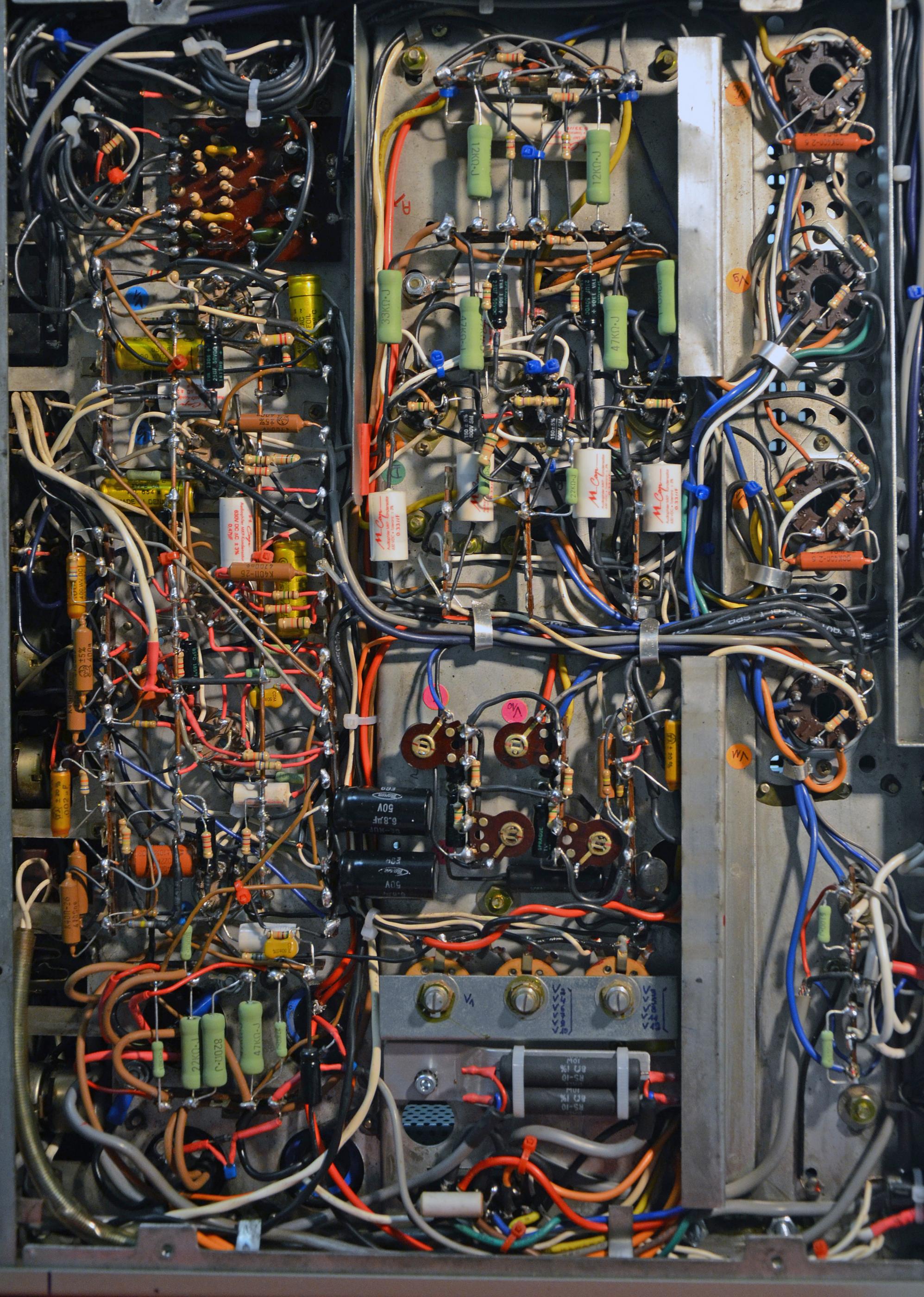

Hello,
I am new to the forum and hope you will excuse my poor English!
I restore amps for several years
I recently bought a very beautiful Luxkit A-1033 (Luxman LX-33) in Japan
Not being sure of its operation, I will start it using a Variac and without the power tubes
I only found the schematics on the internet; unfortunately no voltage is indicated
Can anyone help me (voltages applied on the EL-34 tubes, voltages output from power transformer ...)
A manual even in Japanese would be very useful!

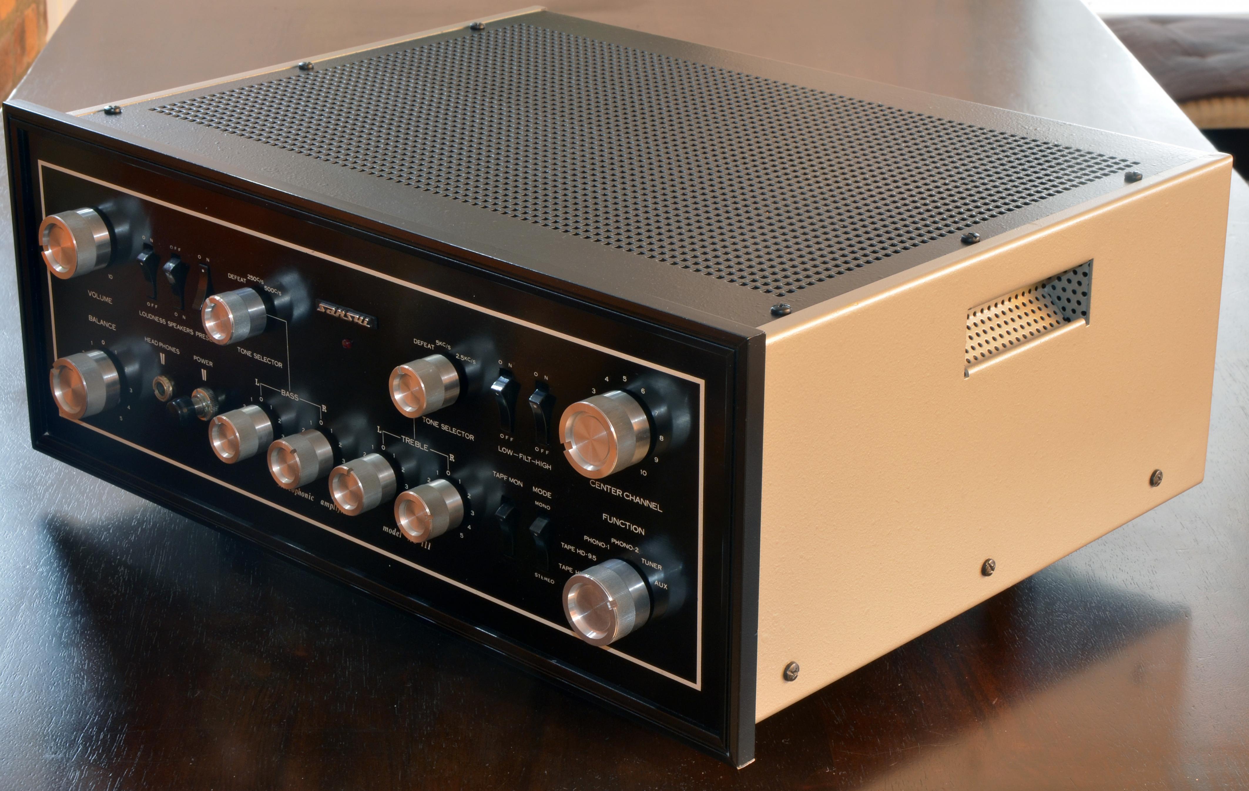

Here is a picture of my last restoration
Thank you for everything and thank you all!

As far as I know, there is no "official" schematic of the LX-33 on the net.
But there is one that I think was drawn from an actual amp. Despite being not too detailed, this schematic is sufficient to work on this amp.
Unfortunately no voltage on this schema, and I have worked on this amp long time ago so I don't have any detailed measurement for you either.
Since you have a variac, you can safely start up the amp and do some quick measurement on vital points (heaters, B+, bias...). Once decided that it's safe to go, you can applied full mains voltage, do measurements yourself, let us know and we can help you judge if the amp is working correctly or not.
However IIRC this amp runs with pretty high B+ even when loaded, it's very easy to surpass rating of power supply capacitors if you apply mains voltage without the EL34s.
I suggest you should disconnect the HT bridge from main transformer first, so that you can safely check the rest of the amp to make sure it will run (more or less) before apply B+.

I would probably replace all supply caps at this point.
i will do this if i were you....
looking at the innards, i see three miniatures feeding the EL34's,
so i would hazard a guess, the your amp is mullard 5-20 like topology
but with a triode as first voltage amp...

I think you are wright, there is no reel schematic on the net, I'll do it myself...
Disconnect the HT bridge first and start slowly with the variac is a very good idea
If it works I'll change the componants anyway, power capacitors first.
I keep you informed
