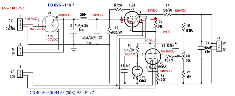

Something went wrong with the 82k measurements. V3 pin 7 is nowhere near 150V, or was this a typo when reporting results?

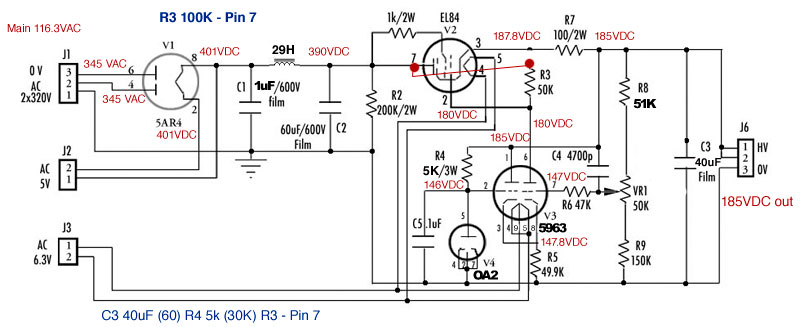

The 100K one looks best - V3 RH now drawing 2mA (voltage across R3 divided by R3 value). You could try 120K too, but probably not much difference. You want R3 current to be around 1-2mA across the whole output voltage range, so V3 is reasonably balanced.
A typo. Should be 147v - so its pretty balanced in that area too. So should I wrap it up with 100K? If so I need to get a higher wattage resistor. I'll be out today so I need confirmation so I can buy at least a 1 watt. When I measured across the 68K it was .5W and I only have .5W resistors in 100K - less in the lower resistance. No need to try R3 back to cathode and the other lower resistances, right? Just want to be sure before I leave in case I need to pick up other resistors. I haven't listened to it with these changes yet. Just wanted to get the results off.

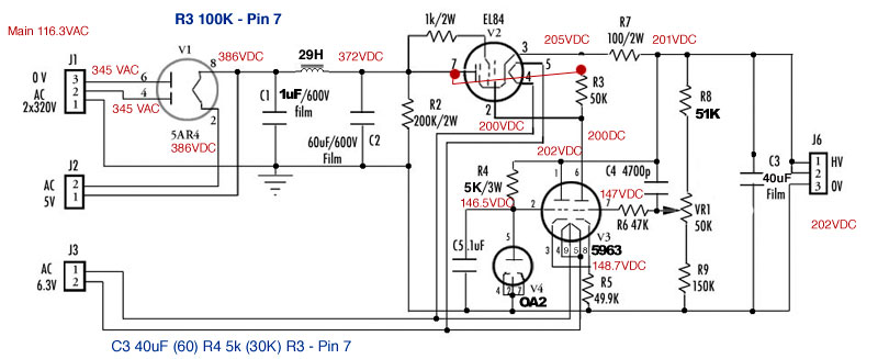

I just did some more measurement with the 100K. Looks like the output dropped to 185V which means I no longer need to adjust R8 - a great outcome. However, when I adjusted the PSU output to 202V needed for me to get 200V on the signal tube plates the voltages changed across the PSU. I guess as expected although I didn't expect it. Here are three more readings to review which also include the corrected 82K. I listened and the hum is down from before but I believe higher than it used to be. If you decide 100K is still the answer I can pick up a couple 50K and center tap to see if that helps.
Arggghhh! I just got back and picked up every value but 18K!! :bawling:
I did pick up 1W 100K though. And 1W 51K (no 50K).
How should I decouple the grid? Split the resistor value in half and junction to ground? Looks like the 1K 2W and goes to grid. Otherwise the grid goes to pin 6 of the 5963.
Ramping it up to the target output voltage still looks good though, right?
51K is an E24 preferred value. 47K (E12 value) would do just as well and might have been cheaper. A 50K resistor would be very expensive, and not generally stocked. As I said, 20% error is plenty close enough for most circuits! So the 18K, as it only makes a small part of the total, can really be anything between 10K and 27K. Use whatever you have. (BTW if you want to learn about component values, Google E24 E12)
The EL84 screen grid (pin 9?) just needs a capacitor to ground i.e. at the end of the 1K resistor. Anything over 10uF should do. If it makes no difference to the hum then omit it. We don't split the resistor on this one as we are not putting a signal here, unlike the control grid.

A pair of resistors (68K/32K) with the junction to ground started to burn the 1W 68K resistor. So I just put in a 1W 100k. In the past when I referenced to ground from the center of two resistors like that I used equal values. Don't know if that made any difference. I just was able to put it in my high efficiency system and its warming up now. Hope to have an uneventful night of music.
