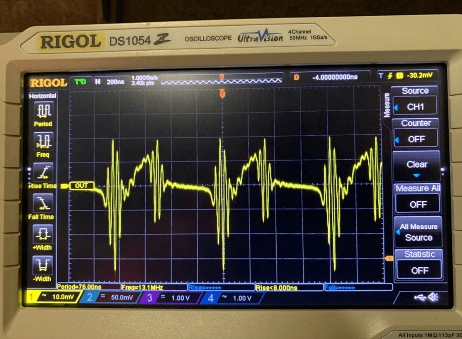

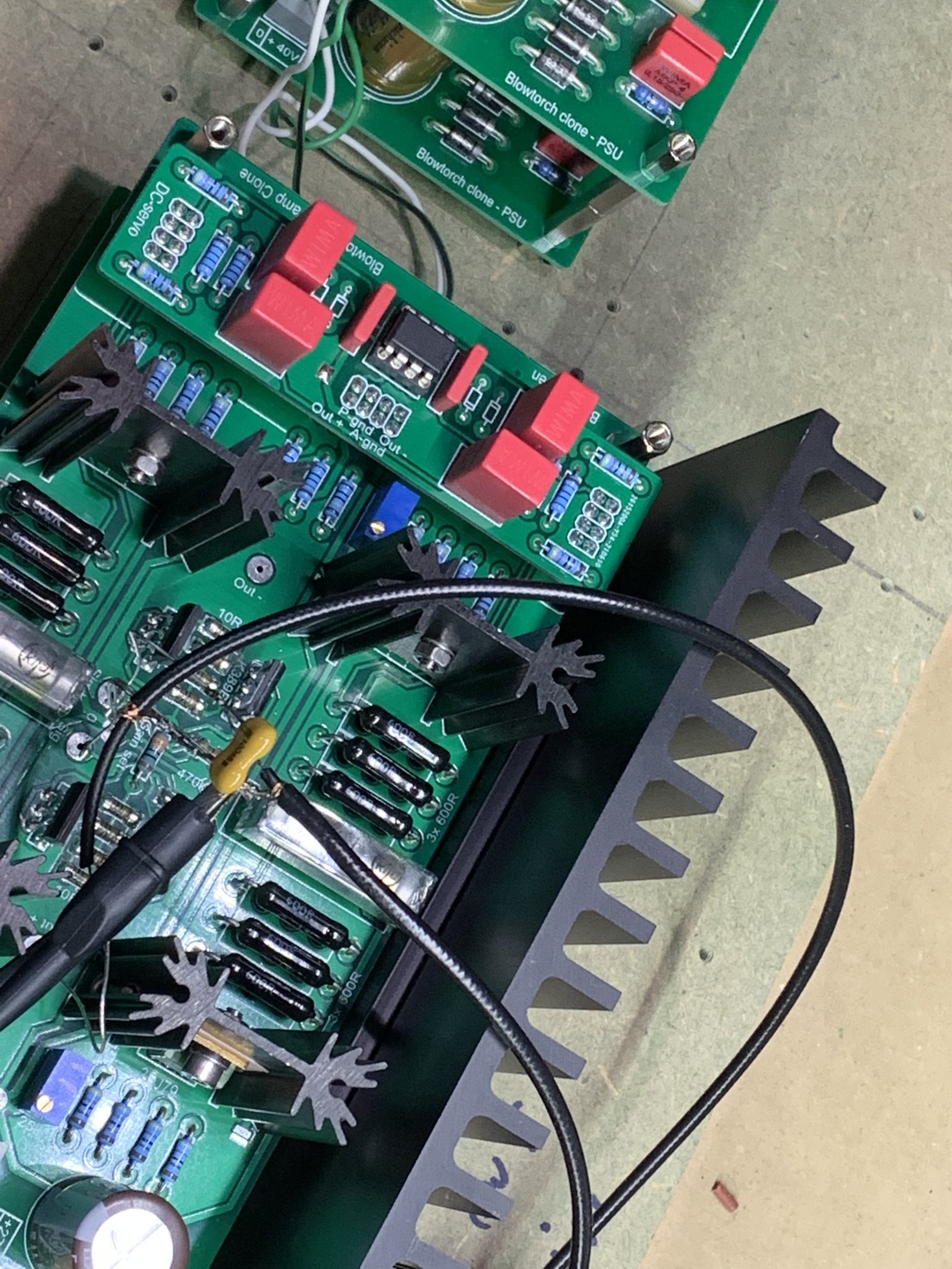

I have an issue with an oscillating line stage, depending on which opamp to use in the DC-servo circuit.
Some details:

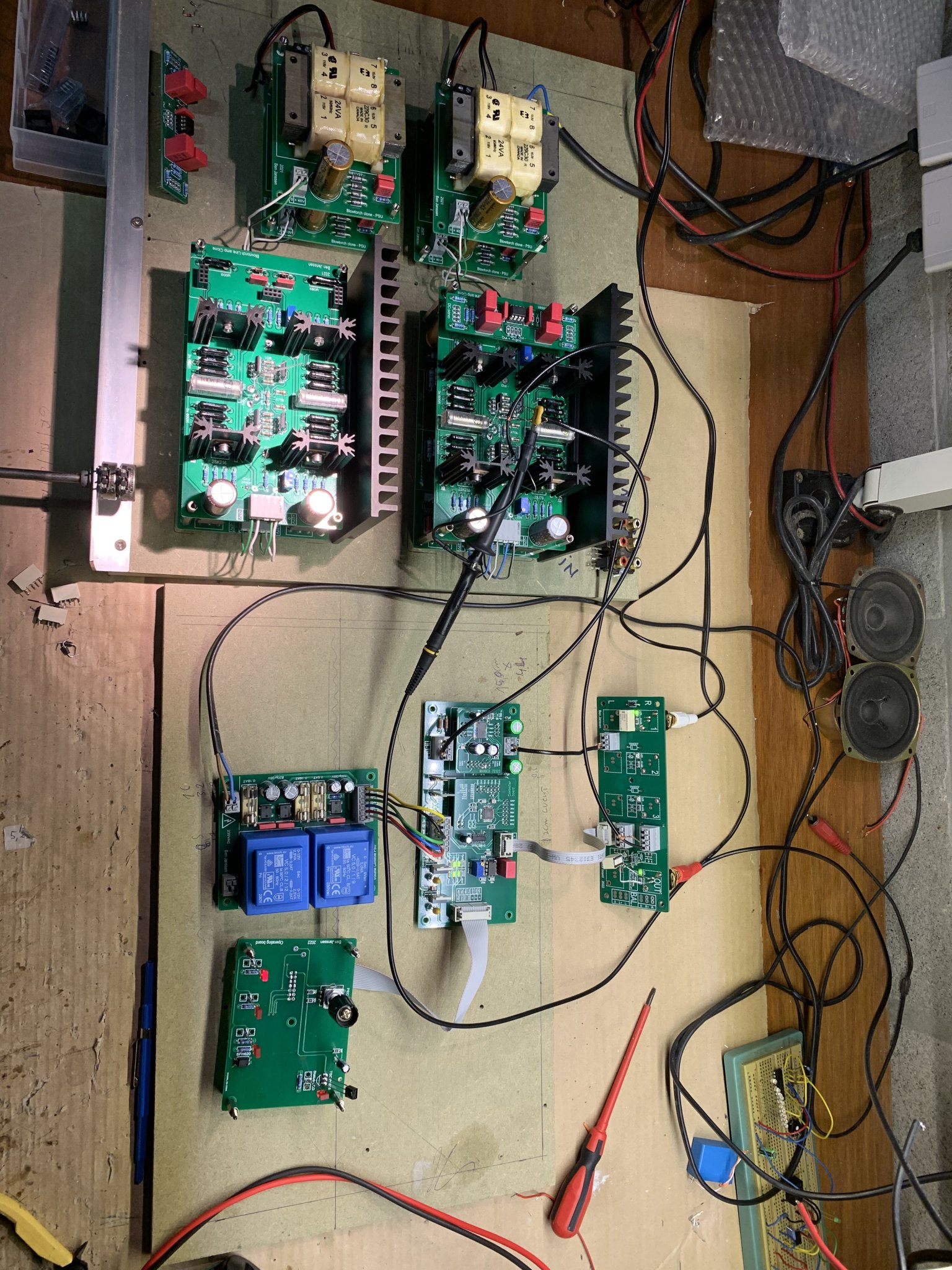

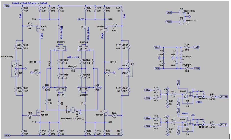

Line stage (PCB + circuit is attached)
  • clone of the famous CTC Blowtorch preamp
  • power supply: CRCRC + LM317 + shunt regulator + Lateral Fet cap multiplier
Servo
  • inverting type. Both opamps inside 1 DIL08 used for balanced line stage.
  • small PCB connected to line stage PCB with headers.
  • Power supply: R + Zener solution derived from line stage PSU. 2x15V zeners bypassed with 100n Wima FKS.
Issue
  • Preamp oscillates easily when using AD712 + switching on/off main amp or source.
  • Preamp does not oscillates when using LF412. Tried many things to get is oscillating, it remains stable.
Trials to find the root cause:
  • 110pF RF cap at input. Between GND and signal. ==> No difference noticed. It still oscillates.
  • 100µF elektrolytic caps // to 100nF WIMA’s, close to opamp + and - connection ==> No difference.
  • Other AD712 ==> No difference
Does anyone has some experience with this kind of issue? All advice is appreciated.

I have two ideas for your issue:
1. The diodes on the input of your servo can be problematic
2. Inverting Servo Type can be unstable with "modern" opamps
I recommend, remove these diodes and try again.
If this does not help, alter your design to non inverting topology.
There is a good article on servos on the net here:
https://sound-au.com/articles/dc-servo.htm
Good luck 🙂
Michael
Just removed the diodes….yes, no oscillation anymore. Thanks for the advice and link.
