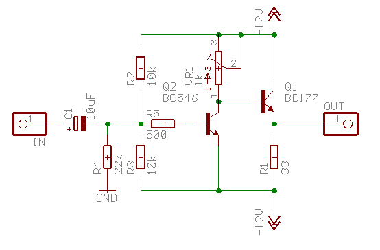

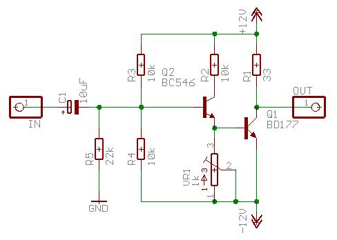

I don't think that the last picture is tweaked enough.
You should add second resistor to the base of Q1 (to -12V) because now bias and output DC voltage depends strongly on temperature of transistor.
Lenny
Lenny
