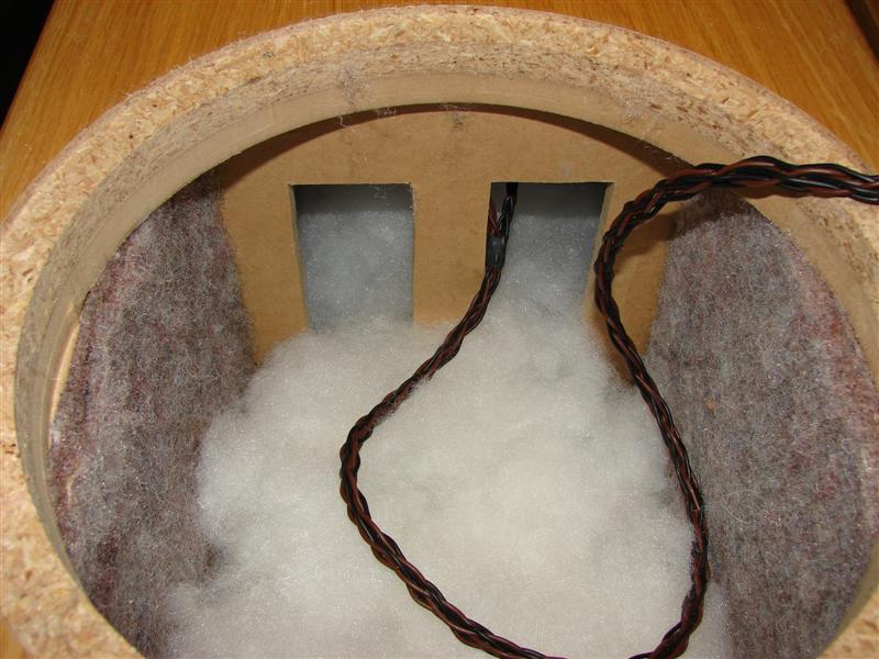

Funny I "just" finished modifying some bandpass boxes for sealed woofer use.
Note the 3/4" particle board then 5/8" MDF glued and air nailed together on all walls. Then carpet pad glued to the walls.

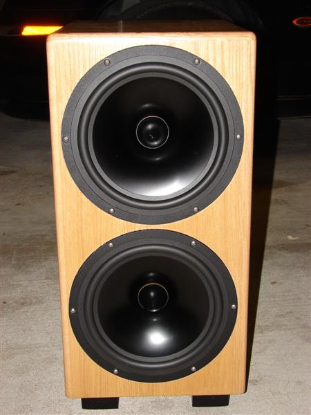

Here is the "almost" finished box. I have to sand the burrs off from the woofer countersink.
Yes the woofer hold down screws will be swapped for black. I just had those on hand at the time.
