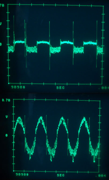

Also again I have the positive and negative spikes ( very close to each other ) on every zero crossing of the 1kHz signal..
No deglitching or filtering yet, just measured on the output pin of the PCM53.

Pictures show -60dB and -80dB 1 kHz signal.
-80 dB already looks like a square 🙁
Wrong data format ?
I had exactly the same problem or even worse when fitting the PCM53 in a JVC player whitch originally has PCM54 DAC.

If you look closer, you can see the square from -80dB also in the -60dB signal.

Still my main problem is how what you see in the picture can happen.
A -80dB sine is converted to a noisy square.
